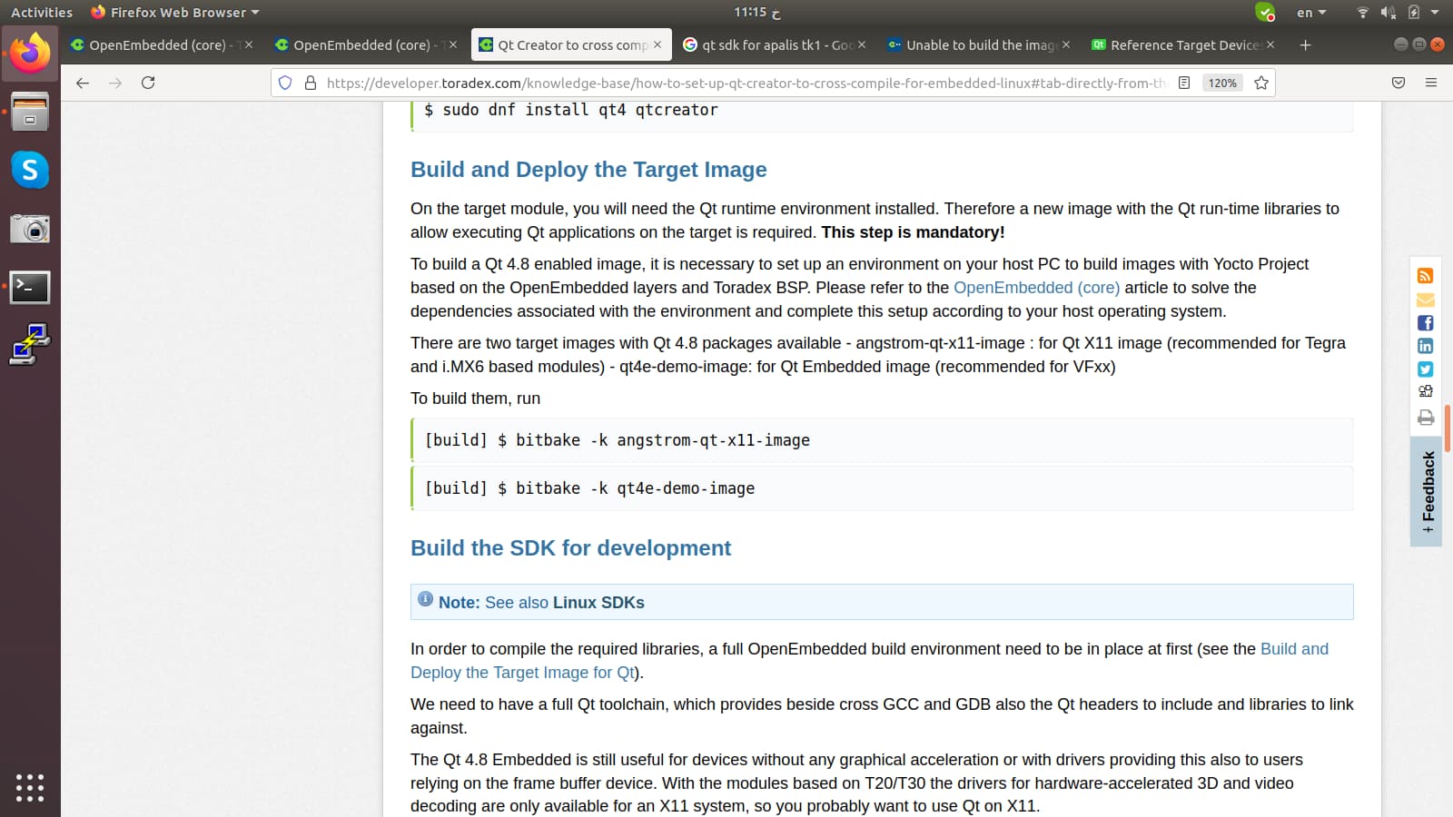

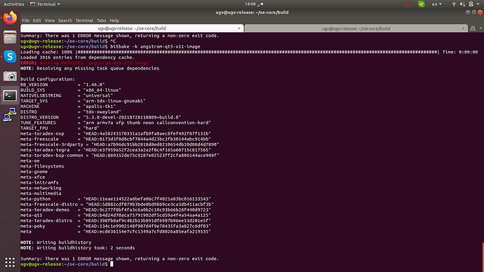

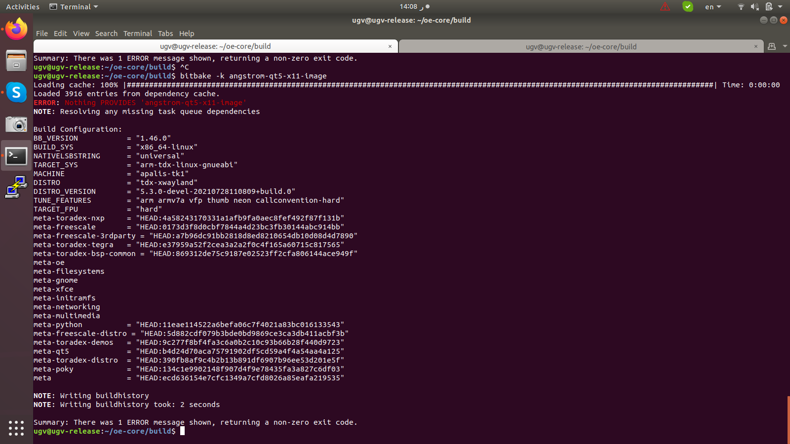

I am trying to apply building QT5 image using this powerpoint you provide
using this command:
bitbake -k angstrom-qt5-x11-image
then i read this

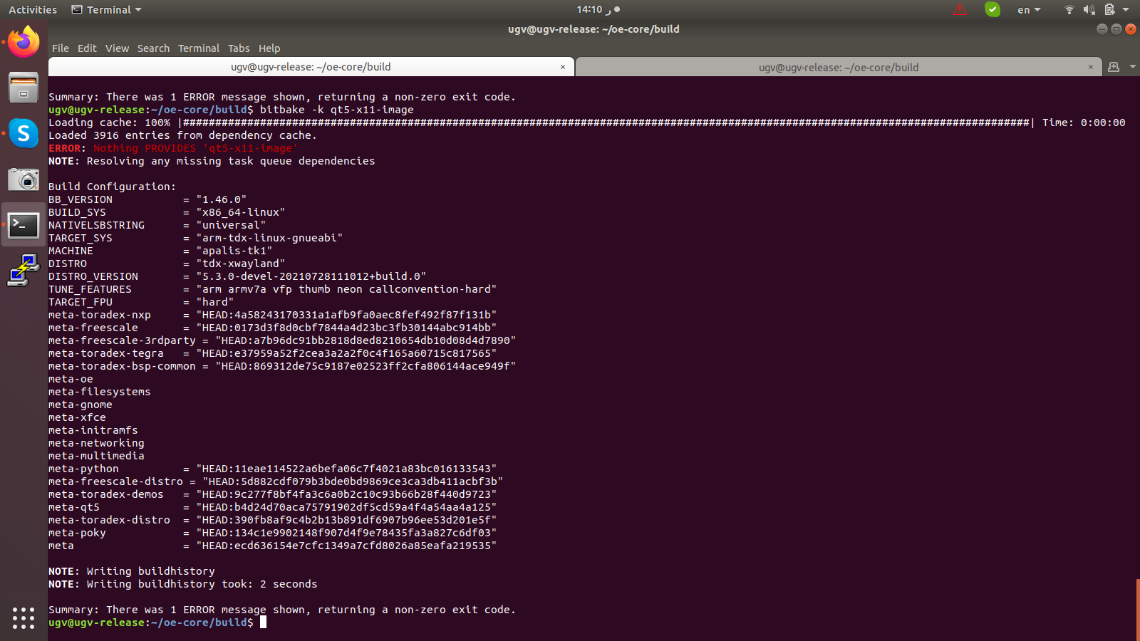

it seems like you have update the inage name, I tried to apply the following command:
bitbake -k qt5-x11-image
but it does not work as well
what is the newest name for the qt5 image to be able to bit bake it without any problems nor errors?

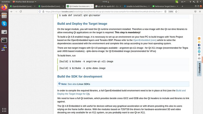

please update this
URL : How to set up Qt Creator to cross compile for embedded Linux | Toradex Developer Center
