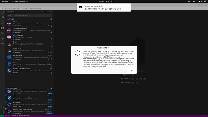

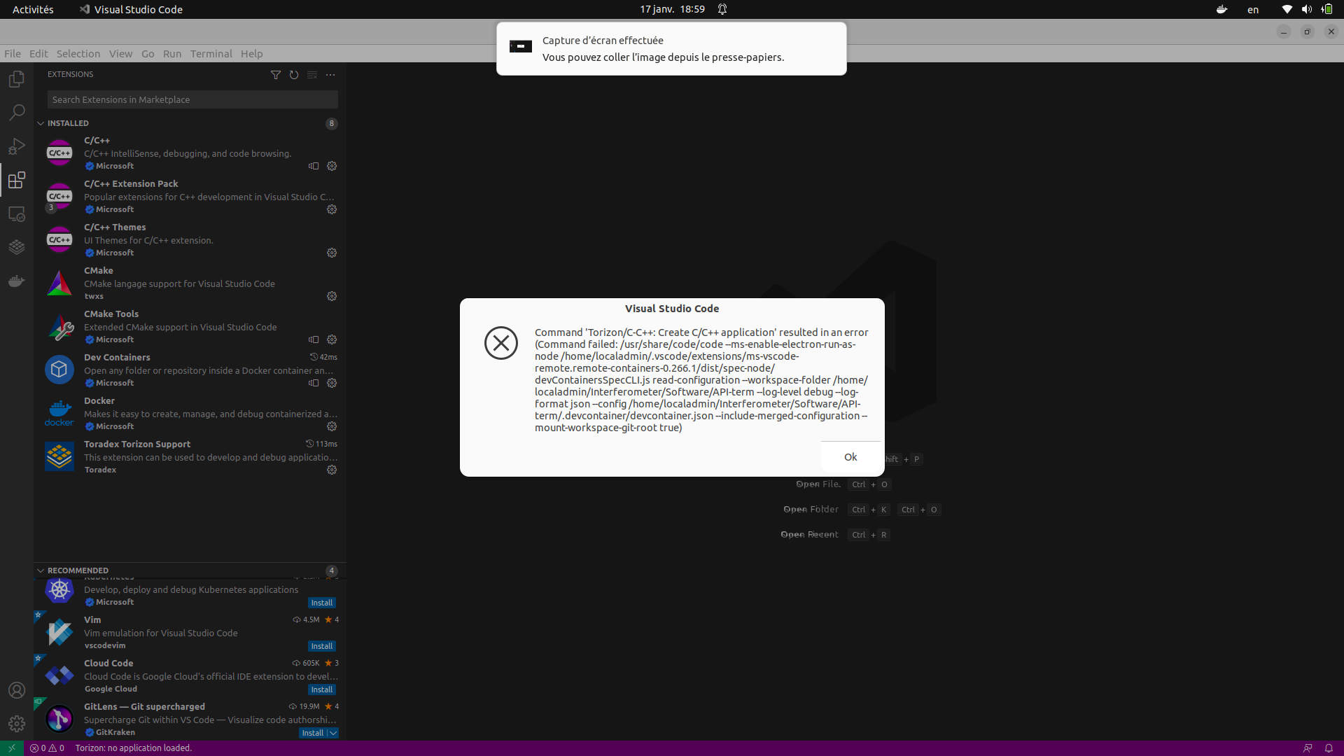

I tried to create a new application (via Torizon C/C++: Create C/C++ Application) but then it did not even finish the setup when I got this error (a screen shot) :
Tomorrow, I’ll uninstall everything and try to start with a fresh environment. It is getting too confused.
