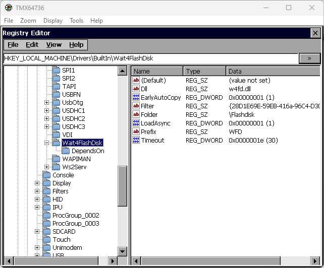

I’m trying to AutoCopy an update for a program that my device normally wants to run using AutoRun. I see the query of the files on the USB Flash Drive occur from the USBs activity LED, and then my program runs. The only problem is that the AutoCopy isn’t overwriting the previous version. I know that AutoCopy is working as i added some additional support files, and I see them in the file structure, however, it still executes the older version of the program. This tells me that it’s executing the AutoRun program before having the chance to finish AutoCopy, and therefore the original program is not being overwritten.
I’ve tried with AutoCopy, EarlyAutoCopy, and enabled the EarlyAutoCopy in the Wait4FlashDisk registry.
Am I missing something, is there a better approach than simply overwriting an EXE with a newer one?
I’m using the Viola Plus carrier board with WinCE 7.0 version 1.9. The USB port is the native USB on the Viola Board as well.

I am getting places with the batch file. I had it do a fixed delay, but now i’d honestly prefer that it not execute the main program until the updating USB drive is detected as removed. This is nice as it also offers a solution to keep the program from running in case i ever need to do anything in the background before committing the watchdog or opening resources from within the main program
this feels close, but it keeps running regardless of if USB HD is present or not
@echo off
echo Checking for Updates…
:wait_for_directory
if exist “\USB HD\”(
echo USB Drive exists… Waiting…
ping 127.0.0.1 -n 3 >nul
goto wait_for_directory
echo Launching Program…
start \FlashDisk\Program\Program.exe
I’d rather use another logic.
Create a \FlashDisk\noupd.flg file, which will indicate that no update process is running and app can be launched. Then, when the update batch file starts, simply remove it at the beginning and recreate it once the update is complete."
@echo off
:wait_for_upd
ping -d 127.0.0.1 -n 3
if not exist “\FlashDisk\noupd.flg” goto wait_for_upd
exit
ultimately, i ended up creating a quick and simple launcher program to accomplish everything, but i also did go the route of removing my old shortcut using the bat file and shortcut to call that.
