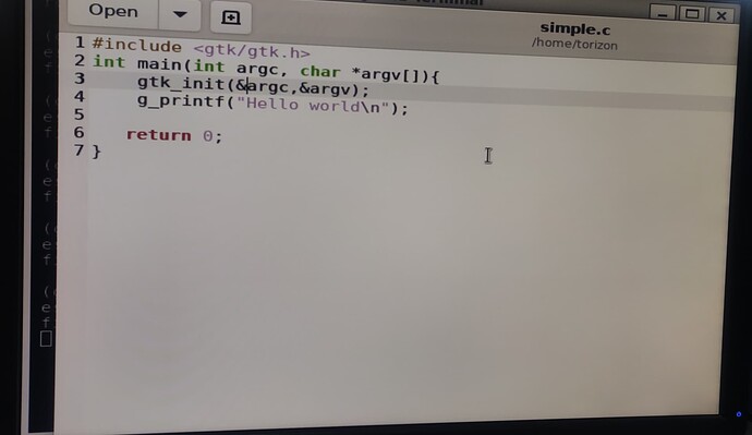

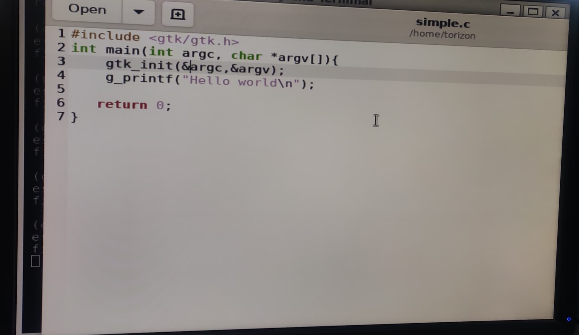

Hello @lucas_a.tx ,
I followed your instructions, and then I’m able to apt update and download gtk2.0 and gedit text editor,
I edited code in gedit which pops up as GUI,
using gedit I add these C lines for simple GTK application.
#include <gtk/gtk.h>
int main(int argc, char *argv) {
gtk_init(&argc, &argv);
g_printf("Hello World\n");
return 0;

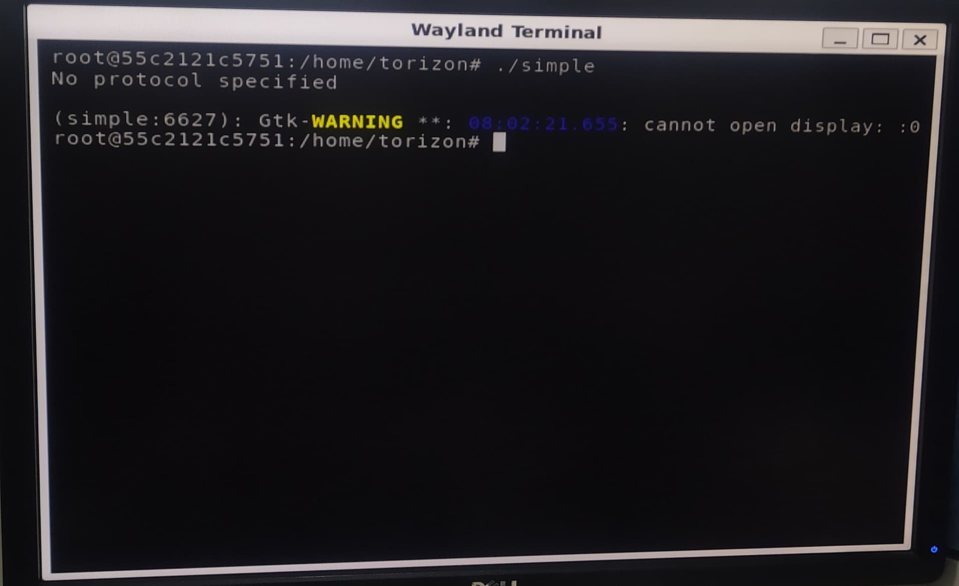

It compiled well, but while trying to run I got the error as shown below
Error: cannot open display: :0
but gedit is also a GUI the why its displaying?
I was able to reproduce this and it looks like it’s related to the fact you’re executing the GTK program as root in Wayland.
It should work if you change the user to torizon
before executing the program. Change the user with:
su -s /bin/bash torizon
I was able to run your test code once I executed the program as user torizon
. For reference, compilation was done with:
gcc simple.c -o simple `pkg-config --cflags --libs gtk+-2.0`
