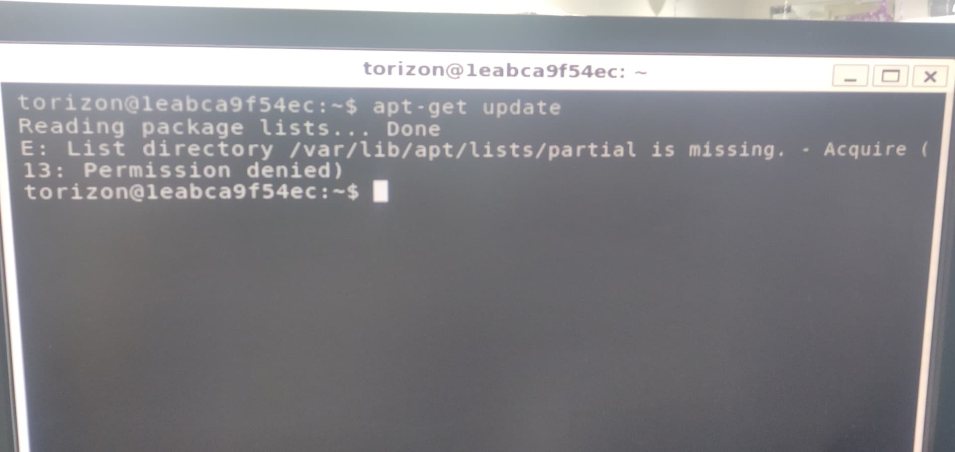

Hello @Nolan_Maverick ,
The default password should be torizon . In case you changed it use the one you created.
Can you try running apt-get update without sudo? It should also work
Josep

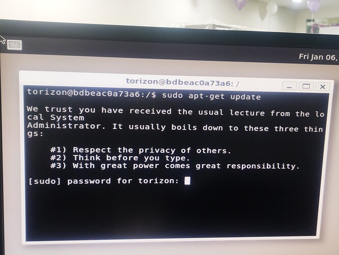

hello @josep.tx
please look this picture I tried but no use
@josep.tx note that password is asking in evaluation container
