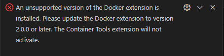

Came back started Visual Code and started going through all the extension updates. saw the one for docker changing to containers and cringed a bit.
so now none of the projects I had working will debug or start on my devices.

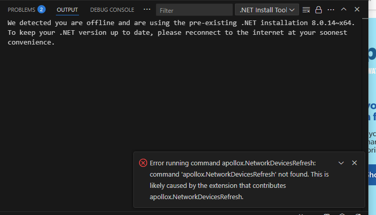

Now I am still learning and figuring all of this out. so I am probably missing something easy. but no matter the project or if I try the simple C++ console project from scratch. I will end up with an error similar to this this:
WARN[0000] The "DOCKER_LOGIN" variable is not set. Defaulting to a blank string.
[+] Pulling 1/1
! powisthreading-debug Warning Get "http://192.168.63.2:5002/v2/": net/http: request canceled while waiting for connection (Client.Timeout excee... 30.0s
WARNING: Some service image(s) must be built from source by running:
docker compose build powisthreading-debug
1 error occurred:
* Error response from daemon: Get "http://192.168.63.2:5002/v2/": net/http: request canceled while waiting for connection (Client.Timeout exceeded while awaiting headers)
* The terminal process "/bin/bash '-c', 'DOCKER_HOST=10.10.10.87:2375 LOCAL_REGISTRY=192.168.63.2 TAG=arm64 GPU=-imx8 DEBUG_SSH_PORT=2223 DEBUG_PORT1= DEBUG_PORT2= DEBUG_PORT3= docker compose pull powisthreading-debug'" terminated with exit code: 1.
* Terminal will be reused by tasks, press any key to close it.
