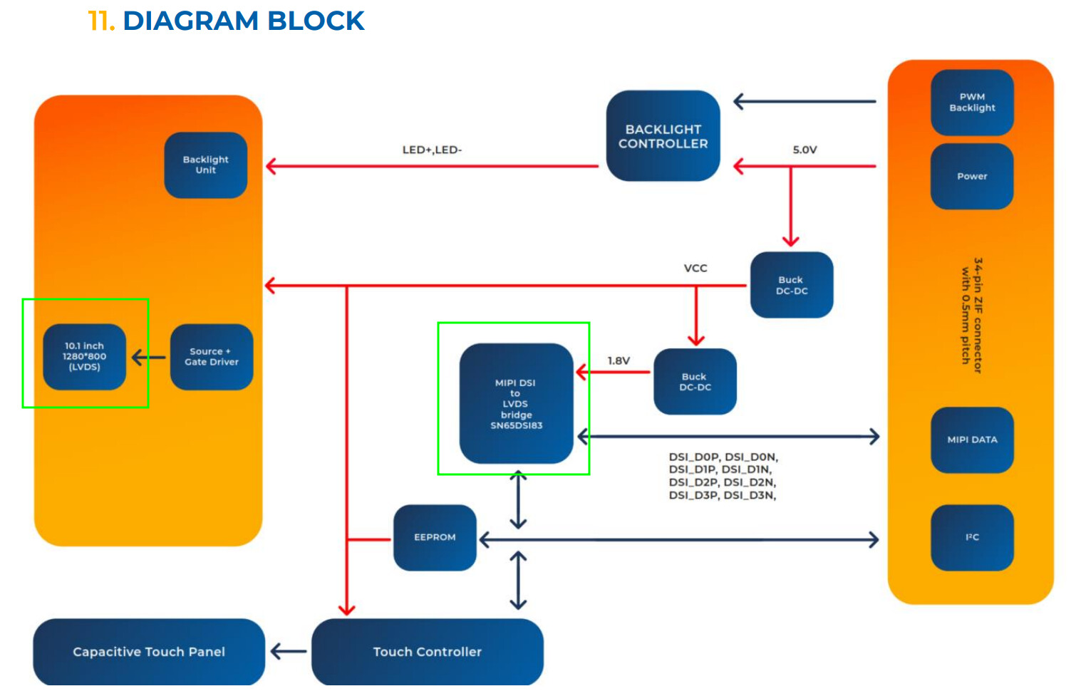

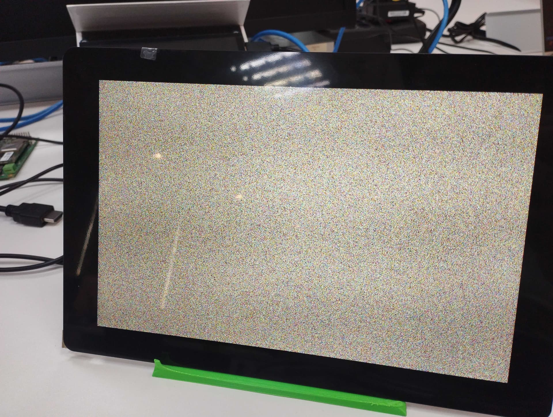

Verdin iMX8M Plus + Capacitive Touch Display 10.1" DSI
I’m trying to get anything to show up on my display but for some reason my Weston container doesn’t want to corporate.
The screen is on and the backlight is “4”.
I am using verdin-imx8mp_panel-cap-touch-10inch-dsi_overlay.dtbo for the overlay.
When I run this command: “find /sys/devices -name “edid”” I get back /sys/devices/platform/display-subsystem/drm/card0/card0-LVDS-1/edid which says LVDS. Is this correct?
Can someone give me some steps to get this to work please

I am using DSI for the display. So I don’t know why LVDS is showing up with hhat command. I am using the correct dtbo.

The biggest issue I think i am finding is that it is trying to use LVDS but I have a DSI board.

About this, I checked with the team.
This is correct and the expected result.
You can refer to the DSI display datasheet, but this is actually an LVDS display with a DSI interface and a DSI-to-LVDS bridge.

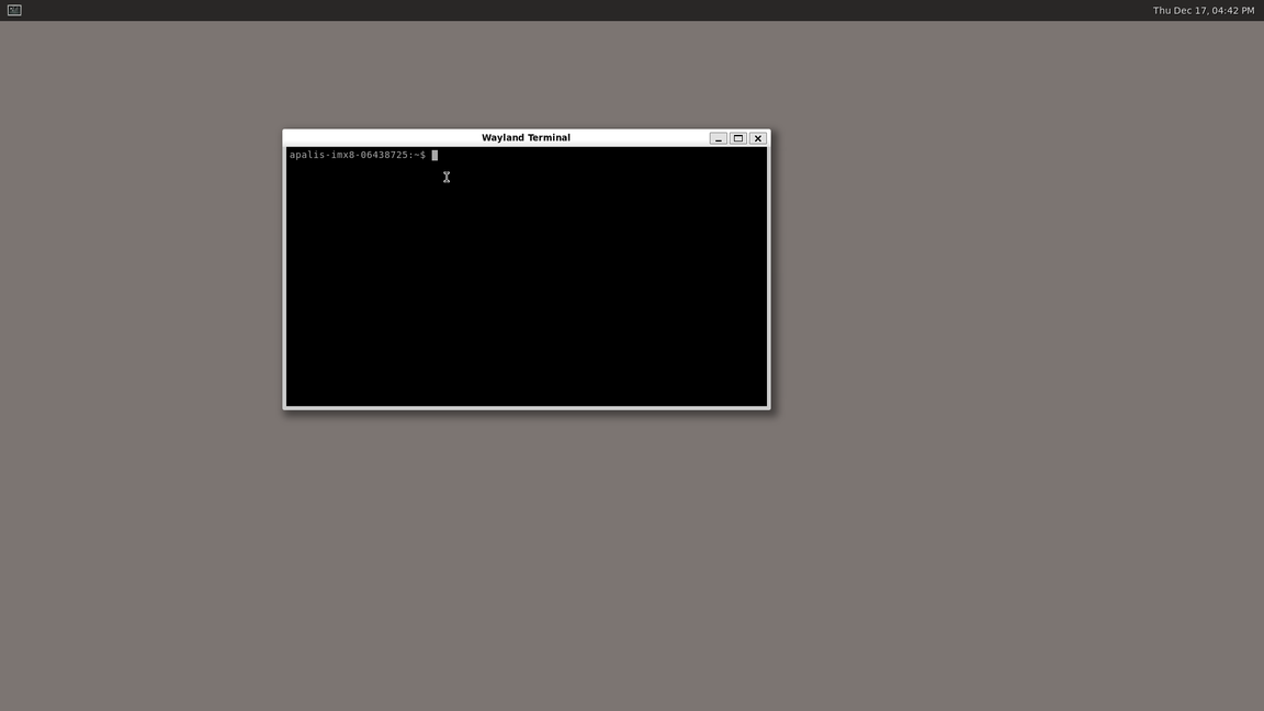

The output I should be expecting is similar to this correct:
Right now the screen is on but nothing is visible.

I don’t think this is going to help. All the packages and dependencies are already inside the container.
yes, this is the output result of running the weston-terminal in docker.
I think the easiest test to validate only the screen is to try writing something directly to the framebuffer.
dd if=/dev/urandom of=/dev/fb0 bs=1024 count=4096
This is going to draw a static random pattern on the screen.
If you still only see the backlight, maybe check the flat connections?
