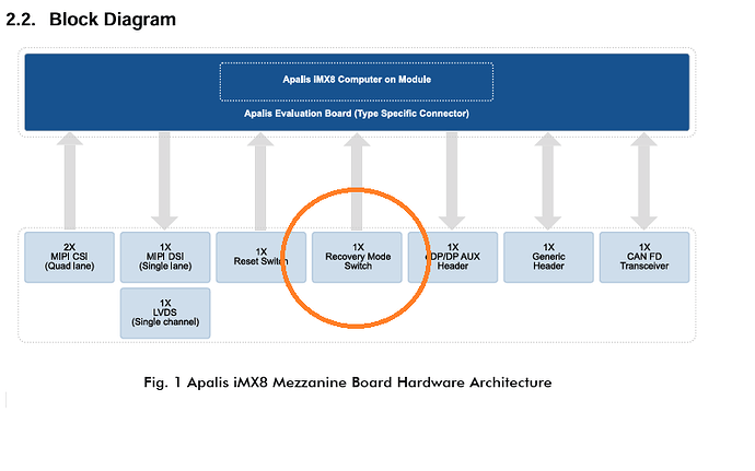

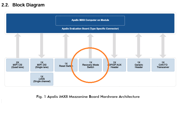

On the Apalis Evaluation Board, you can use the Apalis iMX8 Mezzanine, which has a dedicated recovery button.
Thanks for the suggestion but on an apalis board the recovery pins are hidden on the SoM

Apalis iMX8 Mezzanine is an add-on board for the Apalis Evaluation Board which provides access to the type specific interfaces available on the Apalis iMX8 module.
Thanks for this suggestion.
This will certainly be useful for Apalis Evaluation Board v1.1 where there is no other way to enter recovery mode.
For Apalis Evaluation Board v1.2 there is a recovery switch which could benefit from some more documentation. Once you know how then it does work:
