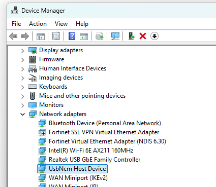

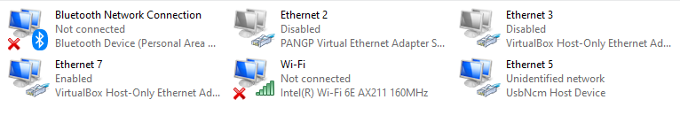

I tried to connect on Windows side with USB-C (X8). But the connection shows up as UsbNcm Host device. So I need to change it to RNDIS mode. But how do I do this? I can’t do it from the Windows side, and I’m not sure how to do it on the Verdin side since I don’t have an interface to the Verdin side yet.

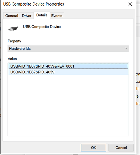

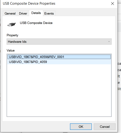

What PID/VID values were detected for the USB device?
I haven’t installed anything, so it should have Toradex Easy Installer installed. PID/VID values are:

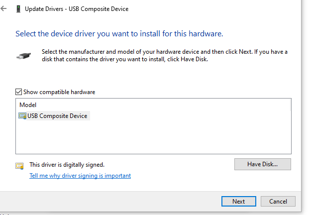

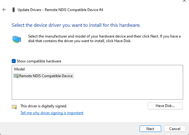

Please try to update driver and select RNDIS
The USB is only showing up as a Composite Device. So I’m not able to select Remote NDIS Compatible device.
Would it make sense to have a call to discuss? What time zone are you in? Let’s set up a time to talk and you can call me at 760-695-8419.

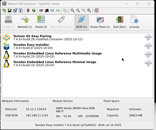

Sorry for the confusion. Yes, when the Verdin iMX95 is running the Toradex Easy Installer, Windows should recognize it as a USB-NCM network device. You can ping it at IP address 192.168.11.1 and use a VNC client to access the Toradex Easy Installer GUI using the same IP address.
We were able to find the UsbNcm Host device and configure it. But now how do we get the Weston VNC backend started on the PC?
By running a VNC client like TightVNC or any other by your choice.

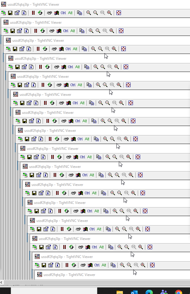

I keep getting multiple windows open when running TightVNC. Have you seen this before? I’m not sure what’s causing it.
Nope.
You mentioned earlier: ‘We were able to find the UsbNcm Host device and configure it.’
Could you describe exactly what configuration you performed?
In my experience, you simply plug in the board and open a VNC viewer — no additional configuration is required.
I meant that I updated the driver in Device Manager like you suggested.
