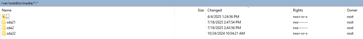

In our application, we use USBs to store extra user data, and also to sometimes to transfer data. The current implementation inside of Torizon v7.2 seems to sometimes not delete the previous folders it created on reboot (power loss) and instead keeps creating new folders to mount USBs to.

Also attached is the example file proliferation from udisks2 after about 10 reboots (in our case, reboots are from power loss to the board)

Interesting, I’ve never actually seen this behavior myself, nor have I seen it reported by others using Torizon OS. That said some searching online seems to support what you said. I’ve seen a few threads on Github where others have described this behavior with Udisks2 as well.
Now for the actual issue. I tried to see if I could reproduce this myself to try and analyze the issue more closely. I did 20+ boot cycles on my device and did not see the issue occur. I only ever had the 1 mount folder appear. Perhaps I was just unlucky, or maybe there are some unknown factors that increase the chances of this happening.
