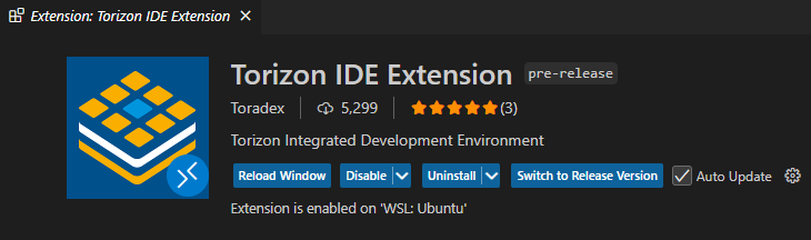

I had torizon working about a year ago and just getting back into the code side of things.
I decided to update to the new torizon IDE Extension on a windows 10 machine.
uninstalled the old extension and went through the new installation process. on that machine after verifying the extension when I click connect to wsl2 VS code will just hang until I close it. docker is running and I can run the a hello world.
So I decided to try on a windows 11 machine with out VS code.
on it the extension will verify but when I connect to wsl2 I do not have the Torizon extension available. after search here and trying a few items I am still stuck. docker does run a hello world
no matter which machine I try I can not get to the point were I was and connect to a device before attempting this update. Now I am a Visual studio guy and have not done much with VS code or WSL. So this is still fairly foreign to me.
so any help is appreciated but at the moment I can not use Vs code and torizon.

I decided to start from scratch and removed Visual studio code and WSL. deleted all associated folders for Visual studio code.
I have installed visual studio code. attempted to install the torizon extention and let it go through it’s process. it went pretty good then failed on no powershell installed. so I got power shell installed in the wsl2 torizon instance. everything looks good. it even found one of the boards.

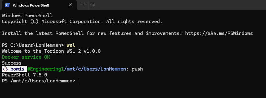

Docker is installed in WSL and runs hello world.
Just to confirm after installing powershell in WSL2, you can run pwsh in WSL2?

this is pwrshell on wsl

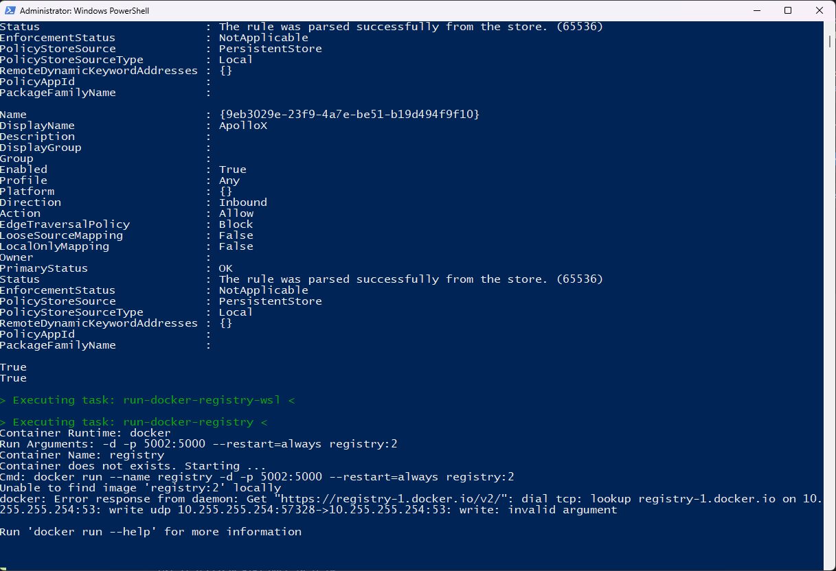

 *  Executing task: DOCKER_HOST= docker compose push pyconsole-debug
WARN[0000] The "DOCKER_LOGIN" variable is not set. Defaulting to a blank string.
Get "http://localhost:5002/v2/": dial tcp 127.0.0.1:5002: connect: connection refused
 *  The terminal process "/bin/bash '-c', 'DOCKER_HOST= docker compose push pyconsole-debug'" failed to launch (exit code: 1).
it just seem like during the initial install of the extension items were skipped or missed. every time I make a change I get a little bit further but never quite there.
I did get this error on the first attempt at debugging. but ran the following command in an attempt to get it running:
docker run -d -p 5002:5000 --name registry registry:2
which gets me to where we are now.

The extension was updated to the latest version (3.0.1 at the time of writing). We also removed an old registry container that was running in WSL with the wrong configuration. Finally, we removed the old templates repository in WSL located at /home/<username>/.apollx. After doing that and restarting VSCode we were able to create a project and do the full debug process.
The issue seems to have been caused by remnants from installing/uninstalling old versions of the extension perhaps.
