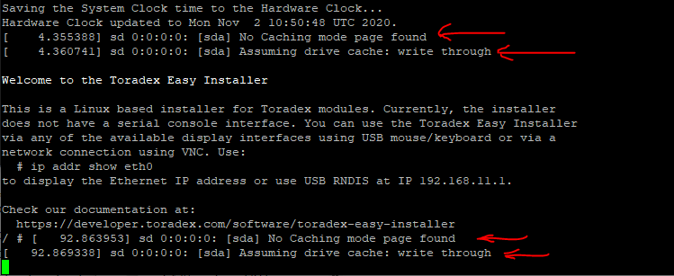

Hi, I obtained a new serial cable, and can now see an output on the serial console when I run the recovery script. I then unzipped the file containing the image I wanted to flash onto a USB drive and plugged it into the board. However, I got an error as shown in the attached image. I also tried running the recovery script with the USB plugged in, but I got the same error (shown in image).
To clarify it looks like you were able to get Easy Installer running, correct? So the UI shows up properly on the connected display?
So is the issue that the software image on the USB doesn’t show up in the Easy Installer UI? If so then perhaps the issue is that the USB isn’t formatted correctly. Only the following filesystem types are supported: ext2/3/4, FAT and NTFS.

The UI does not show up on the connected HDMI display at all.
I connected the HDMI cable to a display, connected the ethernet cable, turned the board on in recovery mode, and ran the recovery.bat script. The output of the serial console was as I showed in the post above, but there is no output on the connected HDMI display.
Hmm this is very odd this happened rarely before but should’ve been fixed. Recently we published known working versions of Easy Installer so you don’t have to go to the nightly feeds anymore. Could you try the appropriate Easy Installer from this list: Toradex Easy Installer Documentation Overview | Toradex Developer Center
If the problem still persists with this newer version can you provide your dmesg logs so I can take a look.
I did end up installing the beta version of the Installer, and the problem I am sharing is for that version. How do I look at dmesg logs?
