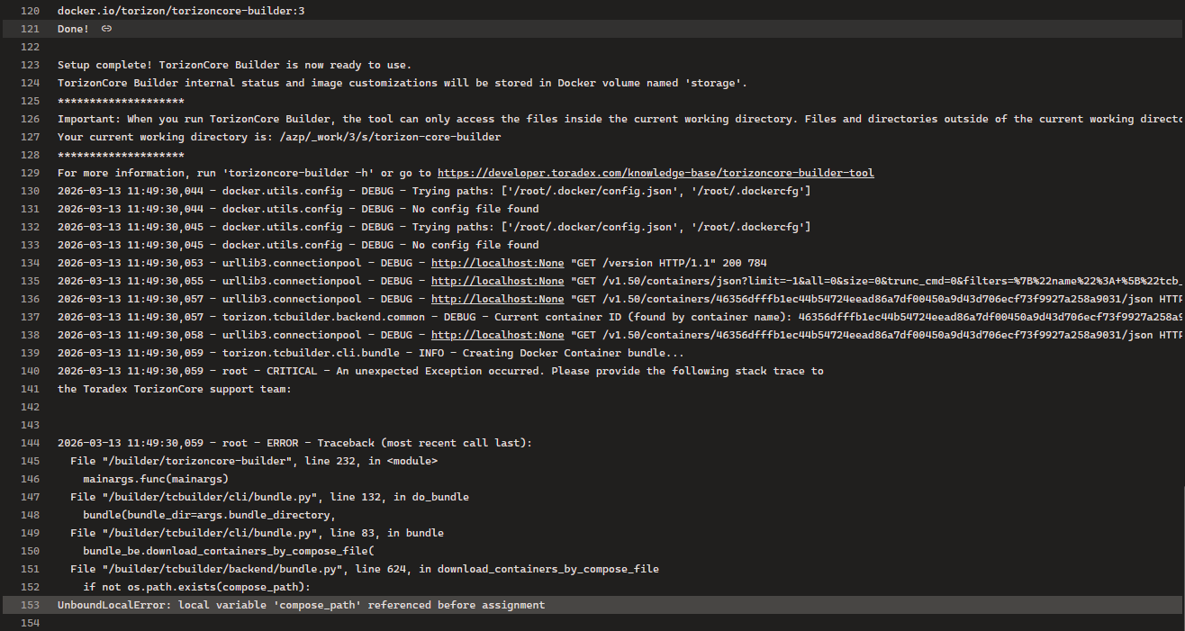

but same OS inside azure pipelines, This error pops up:
torizoncore-builder --log-level DEBUG bundle --platform=linux/64/v8 docker-compose.yml --bundle-directory bundle
When I try to run the bundle command normally, the tcbuilder can’t see the docker-compose.yml in the same folder…
And when I try the full path, the error (see photo) pops up
torizoncore-builder --log-level DEBUG bundle --platform=linux/64/v8 $(pwd)/docker-compose.yml --bundle-directory bundle
