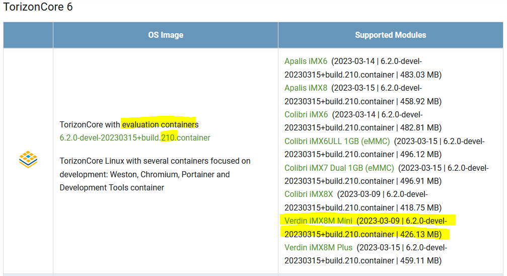

Hi @jeremias.tx
thanks to your email I discovered two interesting things:
  1. not all the bookworm-based containers have been already released. I hope for the booworm chromium soon
  2. The page to download binaries has some problmes with the links: today you can see it sould point to build 210, but if you link on the Verdin iMX8M Mini, the link points to build 202.
    This explains why I think I downloaded build 209 (yesterday), but I got the files for build 202 (which has weston-vivante:2).
    Some of the links point to the right build 210, some to 209, some others to 202.
    On the other side, it seems that the links for TorizonCore (without Evaluation Containers) point to build 210 for all the devices.
Can you verify, please?
And can you share a roadmap for the release of chromium:3 container (bookworm-based)?
Thanks
Not all of our nightly builds succeed. So when we do build 210 for example maybe some devices fail to build or have other issues, in these cases those builds are not published. When that happens the links just point to the latest successful build for those modules.
