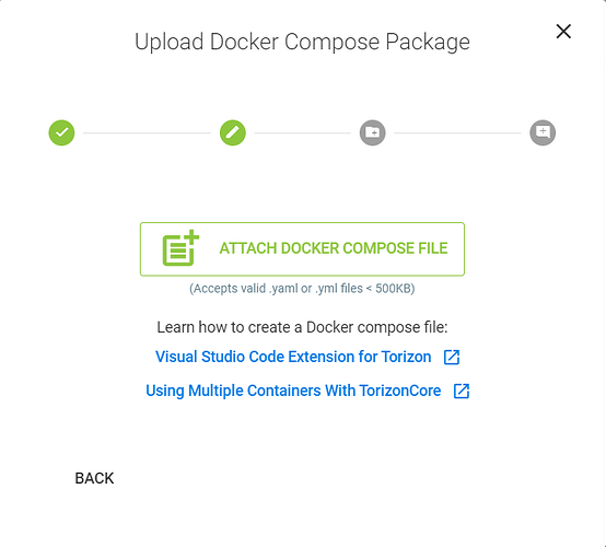

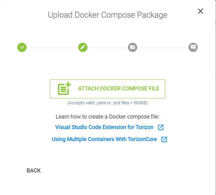

I didn’t pick this example by accident, I took the example because the OTA code recommends it when you are uploading a Docker Compose Package as you can see in the screen snapshot.
Given that, it might make sense either to remove the link on the OTA page or update the example to work with OTA.
