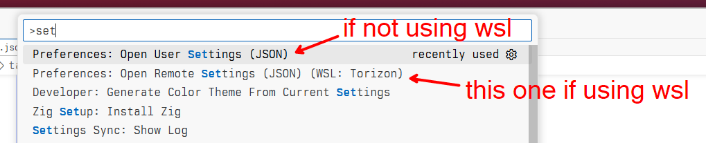

The task that is failing for you is the pre-cleanup. So, VS Code should use the DOCKER_HOST set on the workspace .vscode/settings.json as the remote docker context for the docker commands, the DOCKER_HOST IP should be the same as the value of the torizon_ip property from .vscode/settings.json. But, for some reason VS Code is getting the 10.10.249.220 instead. Please take a look at the global settings.json. Press F1 and then select the option:
Take a look if there is some other DOCKER_HOST set in these files, please.
