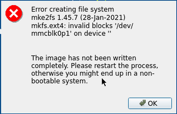

I’m building my own image in Yocto based on the torizon-minimal and want to use fscrypt for encryption.
fscrypt needs the active option “encrypt” in ext4: GitHub - google/fscrypt: Go tool for managing Linux filesystem encryption
Is it possible to enable this option when creating the filesystem with the Easy Installer?
I tried by adding
TEZI_ROOT_FSOPTS += "-O encrypt"
to my local.conf. But I get the following error:

Ok, this is weird.
When adding the encryption option to the mkfs_option by
then the image.json file looks like this:
"mkfs_options": " -O encrypt",
There is a leading space before the -O which seems to be the problem. When I remove this space the installation of the image with the Easy Installer works without problems.
Markus

I don’t see anywhere where we may be adding an explicit space. I believe the issue may be with the appending logic in Yocto. When using the += appending assignment it adds an implicit space as documented here: 3 Syntax and Operators — Bitbake dev documentation
