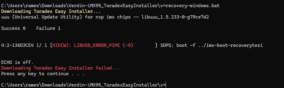

I am facing the issues with the imaging the Verdin IMX95 board on the dev PCB
Using : Verdin-iMX95_ToradexEasyInstaller_7.5.0+build.9
Board “ IMx95 verdin development board.
am using USB OTG and always facing this issue, at times i am getting [HID(W): LIBUSB_ERROR_PIPE (-1) as well.
USB OTG Connection Issues with Verdin iMX95

You probably have the A1 revision of the silicon. The 7.5.0 versions have removed the support for that silicon revision. What does work is the 7.4.0 revision.
Hint: Once you get the easy installer working on the board, it will try to install the 7.5.0 revision of the OS you chose, which will consequently brick your board again. You have to manually download the old OS versions, put them on an SD card and use that one instead of the cloud download via Ethernet. (Contrary to the manual do NOT connect the Ethernet cable!)
(Yes, we over here are also unhappy with Toradex selling us boards with the old A1 silicon when the support for that board was already being removed at the date of purchase.)

Thanks for your reply.
By using the 7.4.0 Tezi, i could able to load the image.

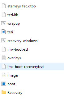

Index of tezi-oe-prod-frankfurt/scarthgap-7.x.y/release/8/apalis-imx6/tezi/tezi-run/teziimage
manually downloaded the following files to run it.
