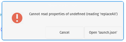

When trying to debug a Rust debug application, the following error pops up in VsCode:
The config looks like:

Any ideas what’s going on ?

Greetings @Giona,
This is a known issue due to a recent update with VSCode itself. The workaround for now is to make the following change in the .vscode/launch.json file of your project. There should be a section in this file that looks like this:
"sourceFileMap": {
                "${config:torizon_app_root}": "${workspaceFolder}"
Change this to this:
"sourceFileMap": {
                "/home/torizon/app": "${workspaceFolder}"
Give this a try and let us know if it helps.
This does solves the problem, thanks!
Perfect glad we were able to help. Meanwhile we’ll try to get the issue officially resolved on the VSCode side.
