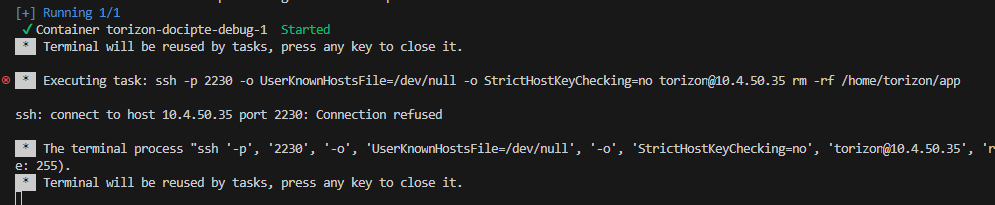

My application only build/starts in 1 of 3 times when I press “Run And Debug” in Visual Studio
This Is the Error i’m getting : Connection refused
This looks to me like a timing issue, Container has just started but ssh is not ready to container.
Any recommendations how to fix this ?

To clarify for us, is it always on this step in the screenshot where your process fails? Specifically this “rm -rf /home/torizon/app” step? Or do you observe the process failing on other steps as well? When it fails is it always the same error?

When I face the issue, it’s always on the same step.
