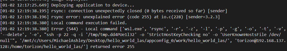

I am struggling with an error from Rsync:
Error "(544) - Local command [‘wsl.exe’, ‘rsync’, ‘-r’, ‘-z’, ‘-l’, ‘-p’, ‘-g’, ‘-o’, ‘-t’, ‘-v’, ‘–delete’, ‘-e’, “ssh -p 22 -q -i ‘/tmp/tmp.iuVHKsoyVm’ -o ‘StrictHostKeyChecking no’ -o ‘UserKnownHostsFile /dev/null’”, ‘/mnt/c/Users/Nirrin/quickstart/appconfig_0/work/quickstart/’, ‘torizon@hostname:/home/torizon/quickstart/’] returned error 255

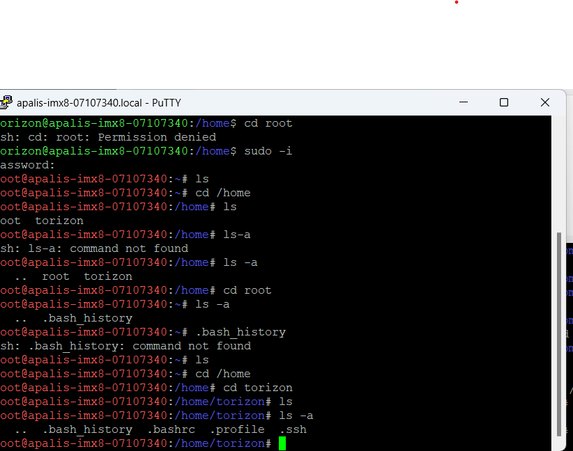

ssh’d into the board using PuTTY in privileged mode looking for the /apalis/torizon/quickstart/ folder and did not find anything except hidden files in either root or torizon.

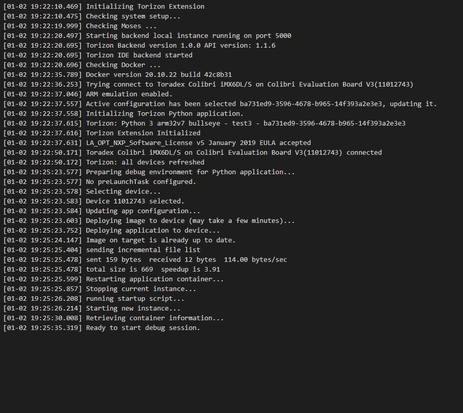

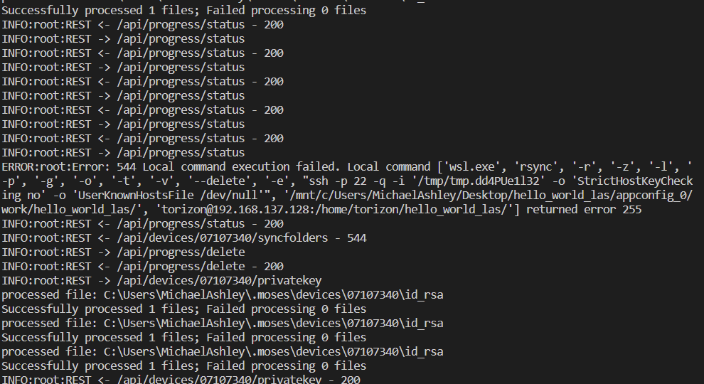

Are you able able to post the output from the TERMINAL and the OUTPUT panes in vscode?

In regards to the other post it does not seem like I have the file they referenced on my board. When I look at the torizon folder on the board in privileged mode all I get is this:
Thanks for the information. I would not expect to see any files on the module under /home/torizon untill there is a successful upload. As it looks like the problem resides in rsync/wsl.
Would you mind verifying rsync installation on wsl?
The issue has been resolved. I was connecting the board to my network via ethernet and internet sharing through my windows computer. It seemed that caused intermittent connection issues between WSL and my board. Connecting via a direct link to our network seemed to fix the issue.
