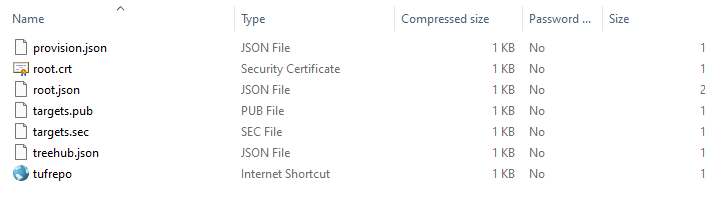

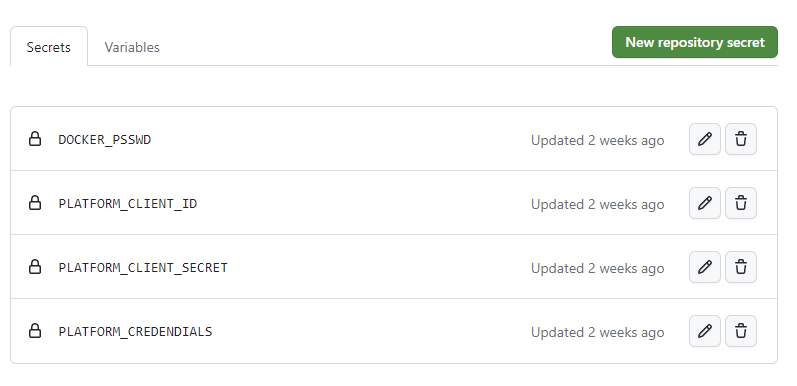

I am getting a failed build on the github actions which says:
Status: Downloaded newer image for torizon/torizoncore-builder:early-access
You are running an early access version of TorizonCore Builder.
An unexpected Exception occured. Please provide the following stack trace to
the Toradex TorizonCore support team:
Traceback (most recent call last):
  File "/builder/torizoncore-builder", line 221, in <module>
    mainargs.func(mainargs)
  File "/builder/tcbuilder/cli/platform.py", line 538, in do_platform_push
    package_info, compatible_with = _check_compatible_with_param(args.compatible_with, credentials)
  File "/builder/tcbuilder/cli/platform.py", line 472, in _check_compatible_with_param
    return translate_compatible_packages(credentials, criteria)
  File "/builder/tcbuilder/backend/platform.py", line 1144, in translate_compatible_packages
    server_creds = sotaops.ServerCredentials(credentials)
  File "/builder/tcbuilder/backend/sotaops.py", line 36, in __init__
    self._load()
  File "/builder/tcbuilder/backend/sotaops.py", line 40, in _load
    with ZipFile(fname, "r") as archive:
  File "/usr/lib/python3.9/zipfile.py", line 1257, in __init__
    self._RealGetContents()
  File "/usr/lib/python3.9/zipfile.py", line 1324, in _RealGetContents
    raise BadZipFile("File is not a zip file")
zipfile.BadZipFile: File is not a zip file
> TASK tcb-platform-publish exited with error code 254 <
Error: Process completed with exit code 1.

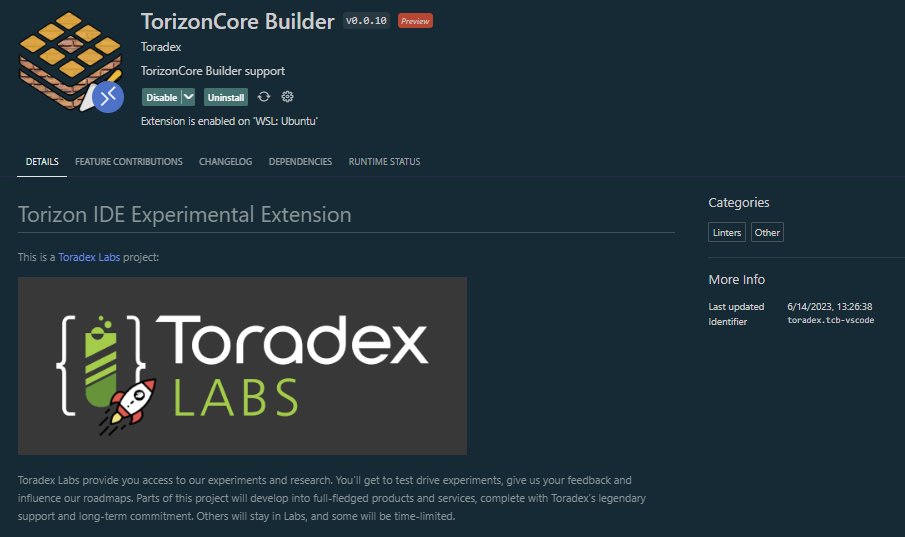

Regarding this, I am unsure what you mean. I am using the version available to me from the vscode extensions. I am working on a Cpp Console template by Toradex. The following is the extension.
Edit: @josep.tx I found the setting to disable the early access version. I changed it to 3.7.0 but the error still remains:

The tcb-platform-publish task currently expects a public container registry. You can modify the task definition in .vscode/tasks.json to instead expect a private registry. The task works by invoking TorizonCore Builder, specifically the platform push command.
You can modify the tasks definition directly to include the --login parameter with your login information for your registry. You can find info on the various arguments and options of TorizonCore Builder here: Commands Manual | Toradex Developer Center
Thank you, Again! :+1: This issue is resolved.
Edit: The job on github action fails on the tcb-platform-publish task with the following error:

Thanks for your input. I already followed the document and have the secrets saved in the repo.
both with and without the credentials.zip

yes, it apparently is:
these are the contents:
ok, because what the integration does is exactly this decode command of the base64 string that you added to the PLATFORM_CREDENDIALS secret.
And the funny thing about it is that writing this here for you I see that on the docs the PLATFORM_CREDENDIALS should be PLATFORM_CREDENTIALS with T instead D :sweat_smile:.
Coud you please add the PLATFORM_CREDENTIALS and try again?
Let me know the result.
BR,
lol.
I changed it to PLATFORM_CREDENTIALS
but the output is still the same.
