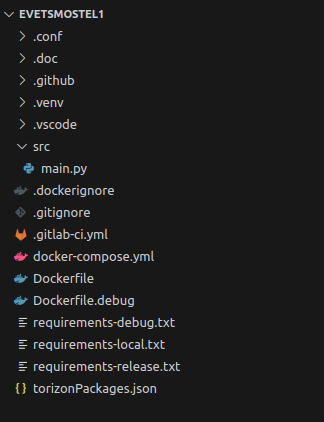

Yes, I have been doing that but I can’t get it to run properly with python. It will build the docker file, but not copy the main.py over to the docker /home/torizon/app/ directory. When I go into that folder, there is nothing there except the venv directory for python environment. This is with the latest templates.

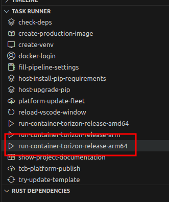

I don’t have a task runner, but it appears to do everything that it should, except the most important ones. It either doesn’t try to build the docker file, and errors out at a later point, but it looks like the docker file is pulled but it doesn’t look like it gets anything., or it gets to where it should stop at the first line of the python script, and then just exits after the wait() task. If I look in the container, there is no main.py file in the /home/torizon/app folder.
