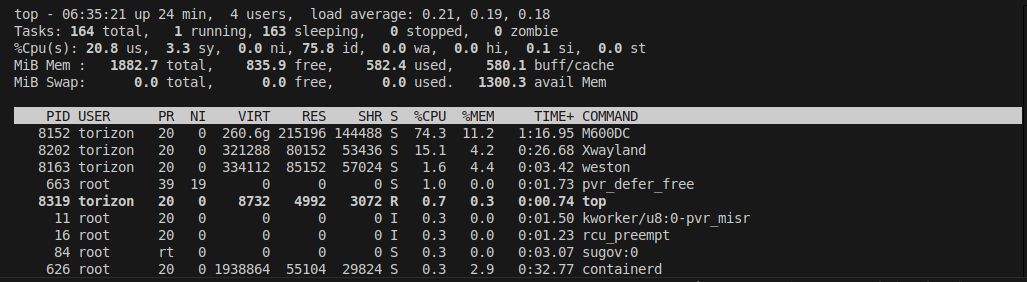

I wanted to ask a question about the Avalonia GTK vscode template. When it comes to animations, rendering, page navigation and general performance the app seems to be lagging pretty hard.
I’m using the standard vscode template from the bookworm branch with a few tweaks. I use the weston compositor instead of xfce, I’ve added [“libvlc-dev”, “vlc”] libs to implement a VLC based video player and ScottPlot for chart support. I also changed the default ReactiveUI binding system to the Community Toolkit.
Edit: Forgot to mention, I’m using the Verdin AM62 board attached to a dahlia carrier board. The display is a connected 10inch DSI panel.
After changing the code in the Program.cs to something like this, it works a little bit better but is still far from being fluent:
Is there something I might be missing that slows down the performance so much?

Greetings @daniel.l,
I believe Avalonia when used with Wayland, uses XWayland. This probably means the whole thing is not hardware accelerated and is not utilizing the GPU. Instead using the CPU for everything. This would explain why you’re seeing not-ideal performance.
While your application here is running could you check the CPU usage on the module. This would help to confirm whether it really is using the CPU for the graphics rendering.
Hi, Jeremias
It does seem that the container app (M600DC) uses around 7-10% of CPU during idle and up to 90% when rendering other pages.
So I guess that the hardware acceleration is not working in that case. How can I enable it?
