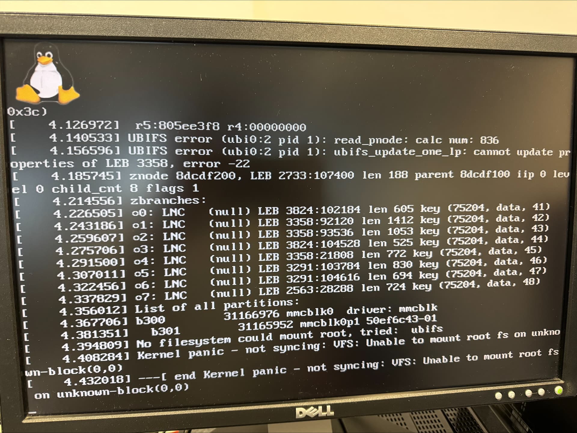

Dear Toradex Support Team,
We have encountered an issue with several VF61 modules after they had been operating successfully for a few months. These modules are running BSP version 2.7.2 of the Linux operating system.
To help diagnose the problem, we have attached an image of the module’s output at startup, showing the error. Could you please assist us in identifying the cause and potential solutions?

VF61 boots and runs very slowly.
The modules have been operating correctly for 8 to 9 months without any issues. However, the problem appeared suddenly after this period.
