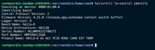

Hailo drivers appear to be installed and functioning correctly:
