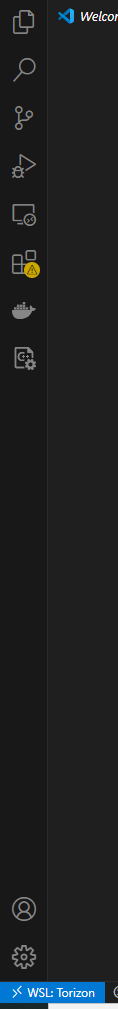

I have several problems getting in with the Torizon IDE Extension in VS Code. My config is a Verdin iMx8M Plus on a Yavia. I set a static IP adress, installed the Torizon IDE Extension in VS Code and by clicking on the button Verify all with WSL2 is done.
When I connect to WSL2 the Torizon extension icon isn’t on the right side, so I have to uninstall the Torizon IDE Extension and also the tcb-vscode and I see the icon after reinstalling. (first problem).

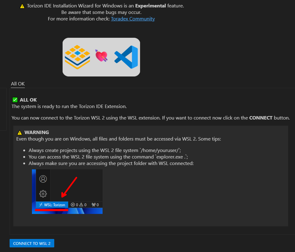

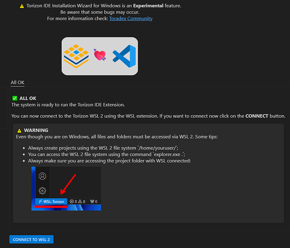

Hi Jeremias,
right now I found a way to install the Power Shell by starting wsl in the Windows PowerShell with sudo apt-get install -y powershell. Output: [03-28 06:21:51.681] PowerShell OK
And with wsl -u root and passwd <username> I could reset the password. A re-install of the Torizon WSL didn’t work but perhaps this was also the wrong procedure. I deleted the Windows-Features ‘VM-platform’ and ‘Windows-Subsystem for Linux’ so that the Torizon-WSL was deleted, too. But when I reinstalled it, I couldn’t create a new user. It seems that the settings are saved and I didn’t find the place where. An uninstallation of VS Code with the user data wasn’t helpful, too.

  1. When I start to connect to the WSL 2 by clicking on the button
    I don’t find the Torizon extension on the left side and I have to re-install it

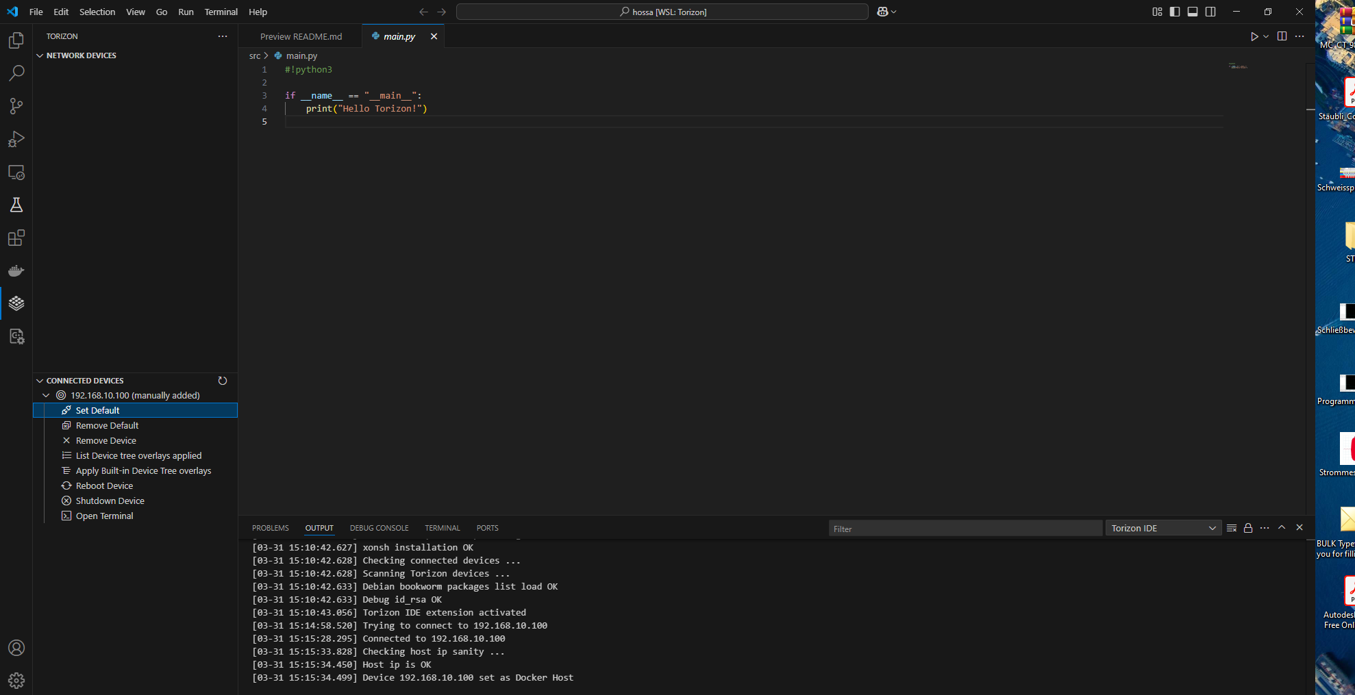

[03-31 09:30:53.894] Checking connected devices ...
[03-31 09:30:53.895] Scanning Torizon devices ...
[03-31 09:30:53.898] Debian bookworm packages list load OK
[03-31 09:30:53.898] Debug id_rsa OK
[03-31 09:30:53.962] Checking host ip sanity ...
[03-31 09:30:54.305] Torizon IDE extension activated
[03-31 09:30:56.418] Host ip is OK
[03-31 09:30:56.469] Device 192.168.10.100 set as Docker Host

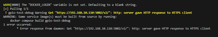

 *  Executing task: DOCKER_HOST=192.168.10.100:2375 LOCAL_REGISTRY=192.168.112.94 TAG=arm64 GPU=-imx8 DEBUG_SSH_PORT=2230 DEBUG_PORT1= DEBUG_PORT2= DEBUG_PORT3= docker compose pull gpiotest-debug
WARN[0000] The "DOCKER_LOGIN" variable is not set. Defaulting to a blank string.
[+] Pulling 1/1
 ! gpiotest-debug Warning Get "http://192.168.112.94:5002/v2/": dial tcp 192.168.112.94:5002: connect: network is unreachable                                                                                         0.0s
WARNING: Some service image(s) must be built from source by running:
    docker compose build gpiotest-debug
1 error occurred:
        * Error response from daemon: Get "http://192.168.112.94:5002/v2/": dial tcp 192.168.112.94:5002: connect: network is unreachable

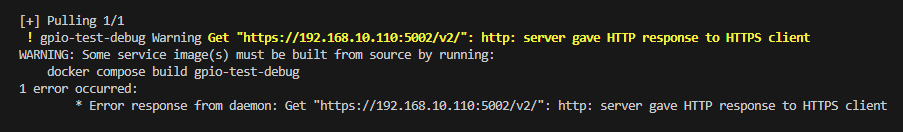

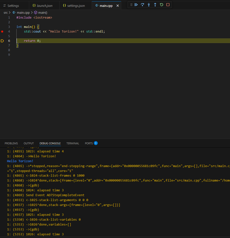

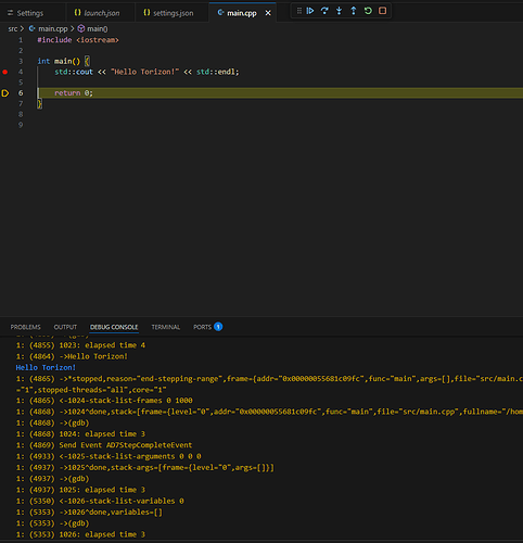

Additionally the debug output tells me:
Starting: "ssh" -T -q -p 2230 -o StrictHostKeyChecking=no -o "UserKnownHostsFile /dev/null" torizon@192.168.10.100 "/usr/bin/gdb --interpreter=mi"
"ssh" exited with code 255 (0xFF).
So I followed the hints on this site: https://developer.toradex.com/software/development-resources/ssh/
But also no success.

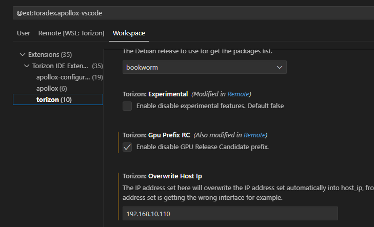

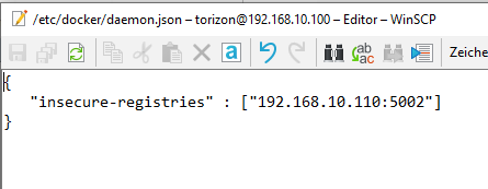

Perhaps it will help to know what I’ve done after installing the Torizon OS7 (I use the PREEMPT_RT 7.2.0-devel-202503+build.7). I set a static ip adress by using the commands nmcli con mod network0 ipv4.addresses "192.168.10.100/24" and nmcli con mod network0 ipv4.method manual

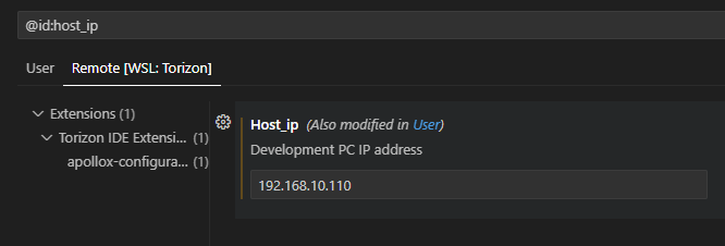

My notebooks ip adress is in the same ip area (192.168.10.110) and subnet mask is (255.255.255.0). I don’t know where the network issue comes from. I am connected to the device and can also create a project correctly but there is a problem by pulling the image from the local server.

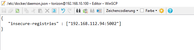

Why is the LOCAL_REGISTRY ip adress 192.168.112.94? Is this because of the setting in daemon.json?
Could this be a problem? Shall / can I change it to the ip adress of my notebook?

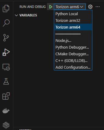

The use of the Torizon arm64 is the correct for debugging?
When you add your device to the extension it writes what it thinks is the IP address of your PC to the device’s daemon.json file. If you’re saying this “192.168.112.94” address is not your PC address then that would explain the strange behavior with connections you are observing. You should manually correct this if you can.
The ip adress "192.168.112.94’ is the ip adress of my WiFi but I’m connected to the board by cable.
I can change the daemon.json by using sudo nano /etc/docker/daemon.json but every time I want to debug it gets overwrite to the WiFi adress. I tried to fill in the ip-adress in the settings for the extension (user & remote) but it seems that this setting has no function:
Network bridge doesn’t work, too. Anything else I can try?
Update: Every time I set the device to default the ip adress will be overwritten. And I have to change the Host_ip in workspace. Now I have to look for this error:
I think the problem is, that the device doesn’t have a connection to the internet. Board network and company network are seperated. Is there a possibility to do this without internet connection?
Wait so what IP address can the Toradex board use to contact your PC?
There is a setting that can overwrite the automatic IP mechanism of the project. This setting is detailed here: Workspace - Settings | Toradex Developer Center
In theory, for the VSCode extension the board should only need to contact your PC that is running VSCode. That said, I’ve never tried such a setup myself. I’ve always done so with the board also having internet connection.
In my example the following static ip adresses are given:
Yavia Board - 192.168.10.100
Notebook - 192.168.10.110
When I fill in the notebook-ip-adress in the workspace setting
the host-ip won’t be overwritten in the settings.json by starting the debugging so I changed it manually but the error message when pulling the docker is the same as before:
Wait did you also change the IP address in the /etc/docker/daemon.json file on your module to match your Notebook IP address?
Yes, I changed it, too.
Could you share what this file contains on your device?
So I tried it this morning again and it works without any changes. I don’t understand why because I restarted the system a few times yesterday…
Well that’s good to hear it works now. Perhaps some change wasn’t taking full effect yesterday for some reason.
Thanks for the help. I think one of the main solutions was the update to 3.0.1 and the overwrite of the host ip.
Well in any case, glad the issues got worked out.
