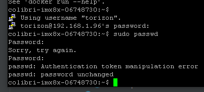

Last week I got a Colibri iMX8X Hardware version D, worked with vB before but now NO Torizon image installed with easy Installer works. With the Torizon for vC the device boots but after login he wants me to change the password, after the first entry putty closes with: passwd: Authentication token manipulation error.

I’m a little confused by your description. So if you’re using the 1.0D i.MX8X you need to use the images that are marked 1.0C or newer.
Once you flash Torizon upon first login with default credentials user:torizon password:torizon. You’ll be asked to change the password for the torizon user. If you’re connected via ssh this will disconnect you after changing the password but you can then reconnect using the torizon user and the new password you just inputted.

Yes I installed 1.0C and connected with putty. And yes after the first connect with torizon/torizon (putty/ssh) I have to enter a new password and confirm it. But after I enter the new password putty closes with the errormessage: passwd: Authentication token manipulation error. So I cannot change the password.

No I know what is different to my previous installation on a vB. It was Torizon v4, now I tried it with Torizon5. Now I installed the latest Torizon4-HWvC(with evaluation containers) and the device is showing the portainer website now. Putty/SSH still not possible with the same error.

I could install Torizon v5 without eval containers and it doesn’t ask for a new pw at first login. BUT I still cannot change the password!
done, marked continous integration server and installed the latest TorizonCore 5.1. Now I’m asked to define a new password, after I enter a new pw ssh closes with the same error. But the display is active and displays the shell. But also there I cannot login with the same error. I see the following problems:

When you manage to login in the TorizonCore 5.1.0 (with or without containers), please try to change the password without using sudo command.
If you use sudo passwd, you’ll try to change root password, which is not the case.
You have to change only torizon password.

  1. Yes I mean SSH access, I never connected via Serial, I use SSH/Putty. What do you mean with Torizon Linux shell?
  2. Some TorizonCore Version worked, because the pw-change was not forced at first login. But “sudo passwd” failed with the same error. Unfortunately I can’t remember which version it was, I think it was an old v5.0

  1. TorizonCore 5.1: no login possible because it crashes at pw-change (passwd) that is forced at first login.

Is the Torizon Linux shell the same as the Linux shell? At the latest version V5.1 from the CI feed it started with display support and I could login on the device. But also there it asks for a new pw and crashes after I enter it for the first time.
