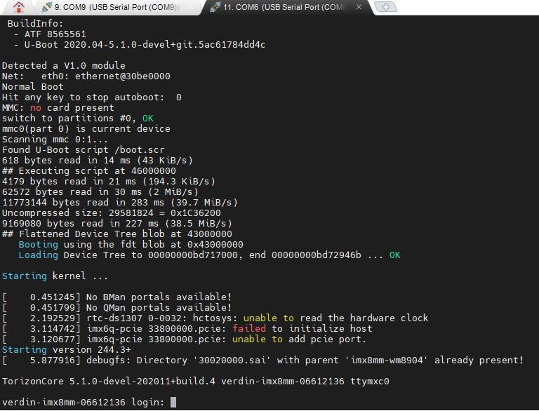

Doing the initial setup from Serial Console:
[upload|Mc3dVQuME7WeDpSE9ZmFmxIFIIw=]

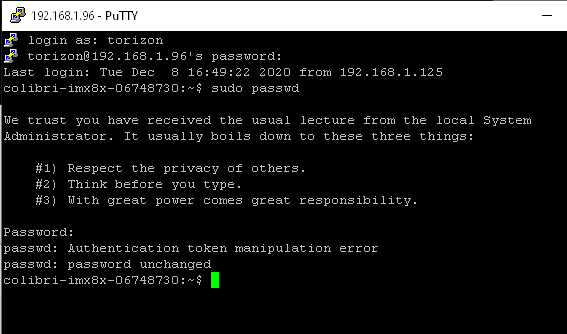

As the times before, ‘sudo passwd’ is not possible:
ok you are right, sudo passwd is wrong, passwd works for user ‘torizon’.
With this workaround it works now.

Hi @syntom,
Please, avoid using “sudo passwd”, as it will try to change “root” password, and that is expected to not work.
Try just using “passwd” to change the torizon user password.
