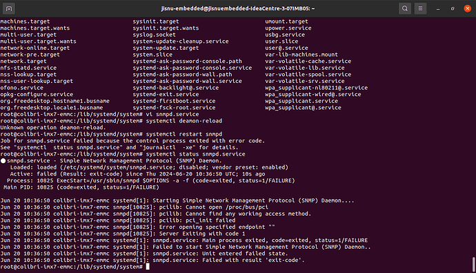

still the error is there cannot open /proc/bus/pci it was making issue while dumping the code into the board
Hi @surya11 ,
You can ignore that message for now and proceed for testing.
You can see that the snmpd is active and running.
Possible reason for this could be that it looks for all possible network interfaces. SImilar post mentioned here

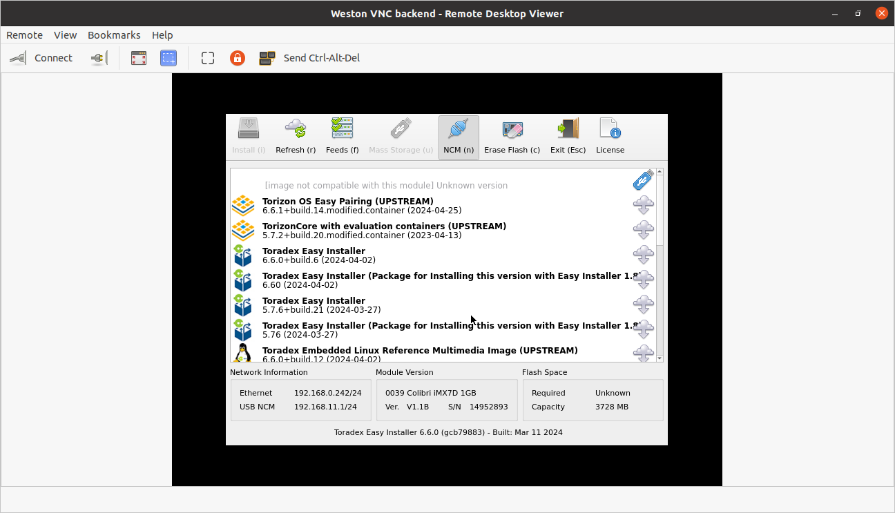

Please use Toradex Easy Installer version 5. The image is compiled for Colibri iMX7D 1GB variant with dunfell branch.

snmp package issue not solved
yes iam talking about the uart communication
snmp is not running
opkg command was not talking in the created image
