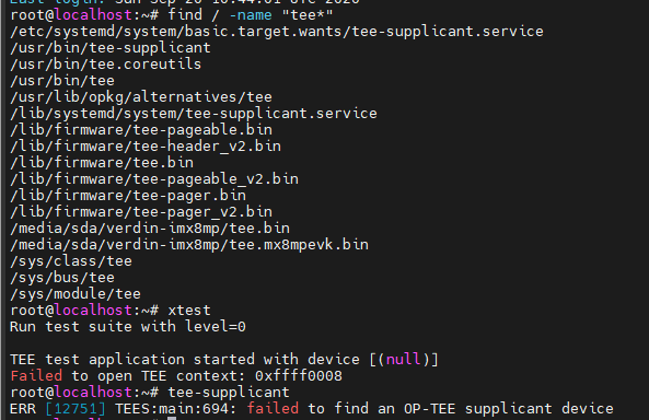

After compiling by bitbake, install the generated image file to the verdin imx8m plus development board using toradex easy install tool. It was found that opee was not successfully installed. I don’t know what is wrong with this. Please point out my problem.

The error reporting problem mentioned above has been resolved. Now I can integrate optee-client optee-test into the root file system by modifying the local.conf file. The following is what I added to the local.conf file:
IMAGE_INSTALL_append =“optee-os optee-client optee-test”
MACHINE_FEATURES += “optee”
The reason I did this is that I used the bitbake -s command to find that there is an optee recipe file that can be used:
optee-client :3.7.0.imx-r0
optee-os :3.7.0.imx-r0
optee-test :3.7.0.imx-r0

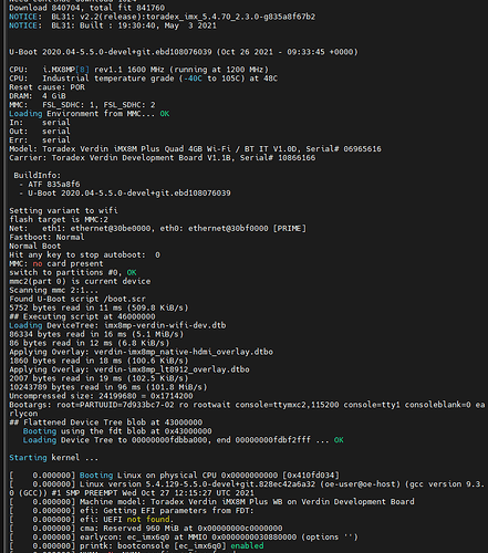

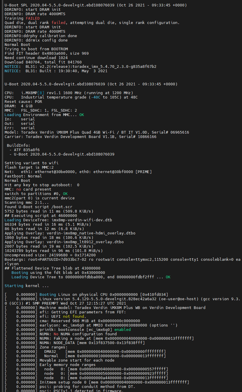

Below is my boot information and inherited root file system 。
