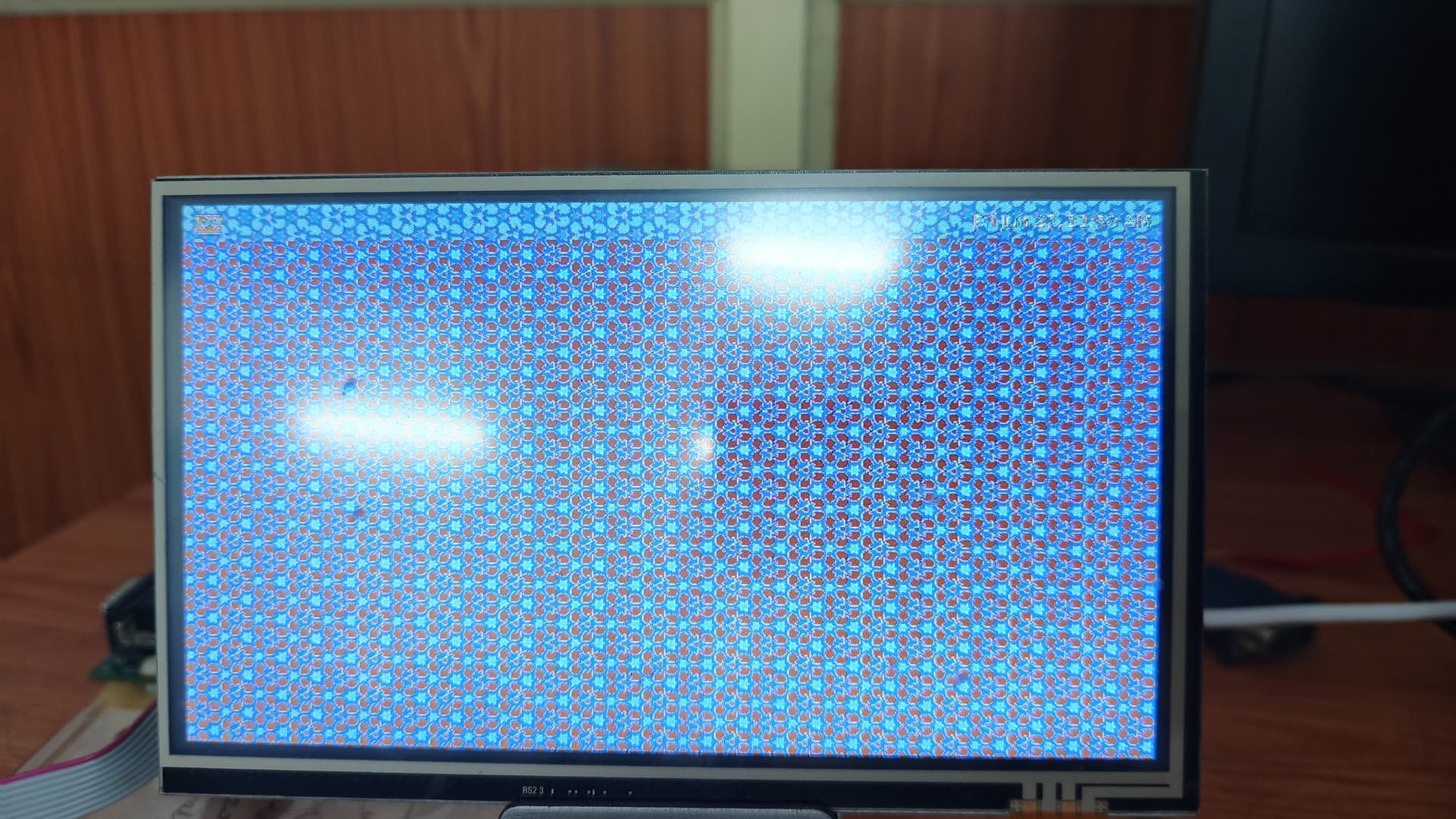

How set Display setting imx7d torizon colibri-imx7_panel-res-touch-7inch_overlay
torizon@colibri-imx7-emmc-06673350:~$ dmesg | grep panel
[ 0.074284] /soc/bus@30400000/lcdif@30730000: Fixed dependency cycle(s) with /panel-dpi
[ 0.074401] /panel-dpi: Fixed dependency cycle(s) with /soc/bus@30400000/lcdif@30730000
[ 1.681565] panel-simple panel-dpi: Specify missing bus_format
[ 1.681588] panel-simple panel-dpi: Expected bpc in {6,8} but got: 0
My dfs file include

I didnt understand where I am getting issue please guide me to fix this problem.I am getting this type of window while setting this dtbo in overlay

yes I am new
7-inch-parallel-resistive-touch-display-800x480-v1.0-datasheet.pdf (3.0 MB)
i attached datasheet for your reference please guide me to set display properly below is my dts file look at it.

please guide me is there any clock frequency mismatch or anything else need to do correction.

  • Missing required properties (bus-format, bpc).
  • Overlay not loaded by bootloader/kernel (check /proc/device-tree/overlays/).
  • Wrong overlay filename/overlay not listed in /boot/overlays.txt.
4. Minimal Example (based on the official overlay)
/dts-v1/;
/plugin/;
    compatible = "toradex,colibri-imx7d",
                 "toradex,colibri-imx7s",
                 "toradex,colibri-imx7d-emmc";
&panel_dpi {
    status = "okay";
    compatible = "panel-dpi";
    width-mm = <154>;
    height-mm = <86>;
    data-mapping = "rgb666";
    bus-width = <18>;
    bus-format = <0x1018>;  // MEDIA_BUS_FMT_RGB666_1X18
    bpc = <6>;
    panel-timing {
        clock-frequency = <25175000>;
        hactive = <800>;
        vactive = <480>;
        hsync-len = <128>;
        hback-porch = <88>;
        hfront-porch = <40>;
        vsync-len = <2>;
        vback-porch = <33>;
        vfront-porch = <10>;
        hsync-active = <0>;
        vsync-active = <0>;
        de-active = <1>;
        pixelclk-active = <0>;
&backlight {
    status = "okay";
&lcdif {
    status = "okay";
&pwm1 {
    status = "okay";
&ad7879_ts {
    status = "okay";
Check that you:
  • Use only normal, straight quotes ".
  • Save and compile with dtc properly (no syntax errors).
  • List the .dtbo in /boot/overlays.txt.
Summary
  • Try the pre-built official overlay first (recommended).
  • If customizing, only change timing.
  • Always use straight quotes, correct bpc/bus-format syntax, and double-check your dtbo is loaded.
If you follow the above and the issue persists, please share the result of:
cat /boot/overlays.txt
ls /boot/overlays/*.dtbo
dmesg | grep overlay
dmesg | grep panel
Useful links:
