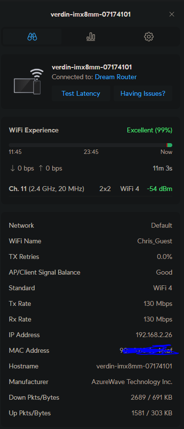

The connection looks stable, signal strength looks ok:

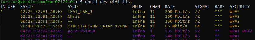

Would you be able to share the output of nmcli with a command such as nmcli dev wifi list?
If the networks are mentioned twice in nmcli this suggests that the culprit is somewhere within that area.

here the output of the available networks. I am connected with “TEST_LAB_1”:
I disabled the 5G Network on the Router, there should only be one 2.4G Test lab SSID.
The UAP device is showing up when running nmcli:
uap0: unmanaged
“Marvell Wi-Fi”
wifi (mwifiex_sdio), 90:E8:68:6C:44:AF, hw, mtu 1500
Chris
