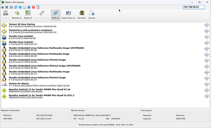

Hi @matheus.tx . Thank you for your response.
I have tried both flows. In both I had the issue with the docker: 'compose' is not a docker command.. But in new flow I did not managed to download the .NET 8 SDK from the script that check those dependencies because it states error 401, so I have installed the SDK manually into the Torizon OS WSL by using the apt-get command from Microsoft.
@jeremias.tx, I think your information is critical for me. I have installed the version 5.7.2 that was listed on Toradex Easy Installer, I did not know that I can download the 6.x version from Torizon OS Embedded Linux Images.
I will try this new version to see if I can use both flows.
Thank you for now. I will back to you guys tomorrow.
When you first used Toradex Easy Installer there should have been an option to install 5.7.2 or the latest 6.X release for Torizon. Did you not see or have the 6.X option? I believe the latest release is 6.6.1.
I did not (at least, I believe not). In first time all images listed on Toradex Easy Installer did not include this. I just saw the Toradex Easy Pairing (first on the list) and the Torizon OS with evaluation containers 5.7.2 (second on the list) and other Linux options.

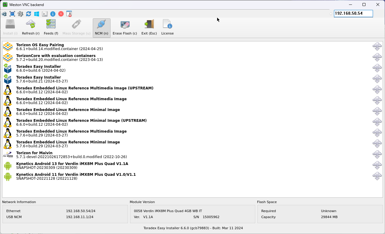

I will put my cpu into recovery mode to get the OS list available and take a print screen using VNC if I can.
Just to give you @jeremias.tx a feedback. Here’s what is showing to me.
That “Torizon OS Easy Pairing”, image is the latest software for Torizon that you should be using as a starting point.
Thank you @jeremias.tx , I installed the Torizon OS Easy Pairing version and I can confirm that now everything works just fine with the C# .NET 8 Test Application.
Perfect glad we were able to assist.
