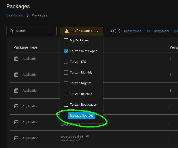

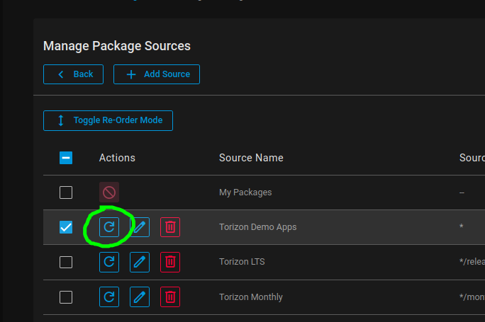

To be clear, did you first refresh the tdx-containers package in the ui?
And then hit refresh:

After refreshing them I am getting successful pushes, thank you!
No worries. It’s an odd thing to do for offline updates… i think we should add a call in tcb to refresh this on behalf of users so doing it manually isn’t necessary.
