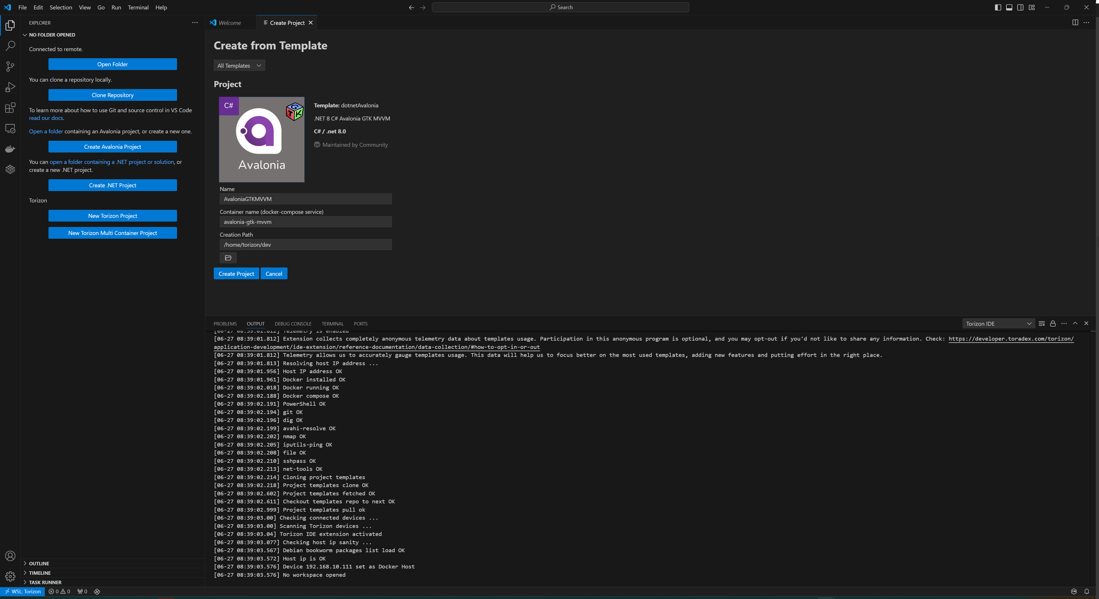

When I open my new project based on the Avalonia .NET 8 Frame Buffer DRM, located in the directory /home/torizon/dev/AvaloniaFrameBufferDRMTest on my WSL2 Torizon OS created by my new Torizon IDE extension 2.5.1, I have the task check-deps which is ran, and there is a problem in my file /etc/os-release.

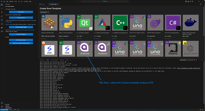

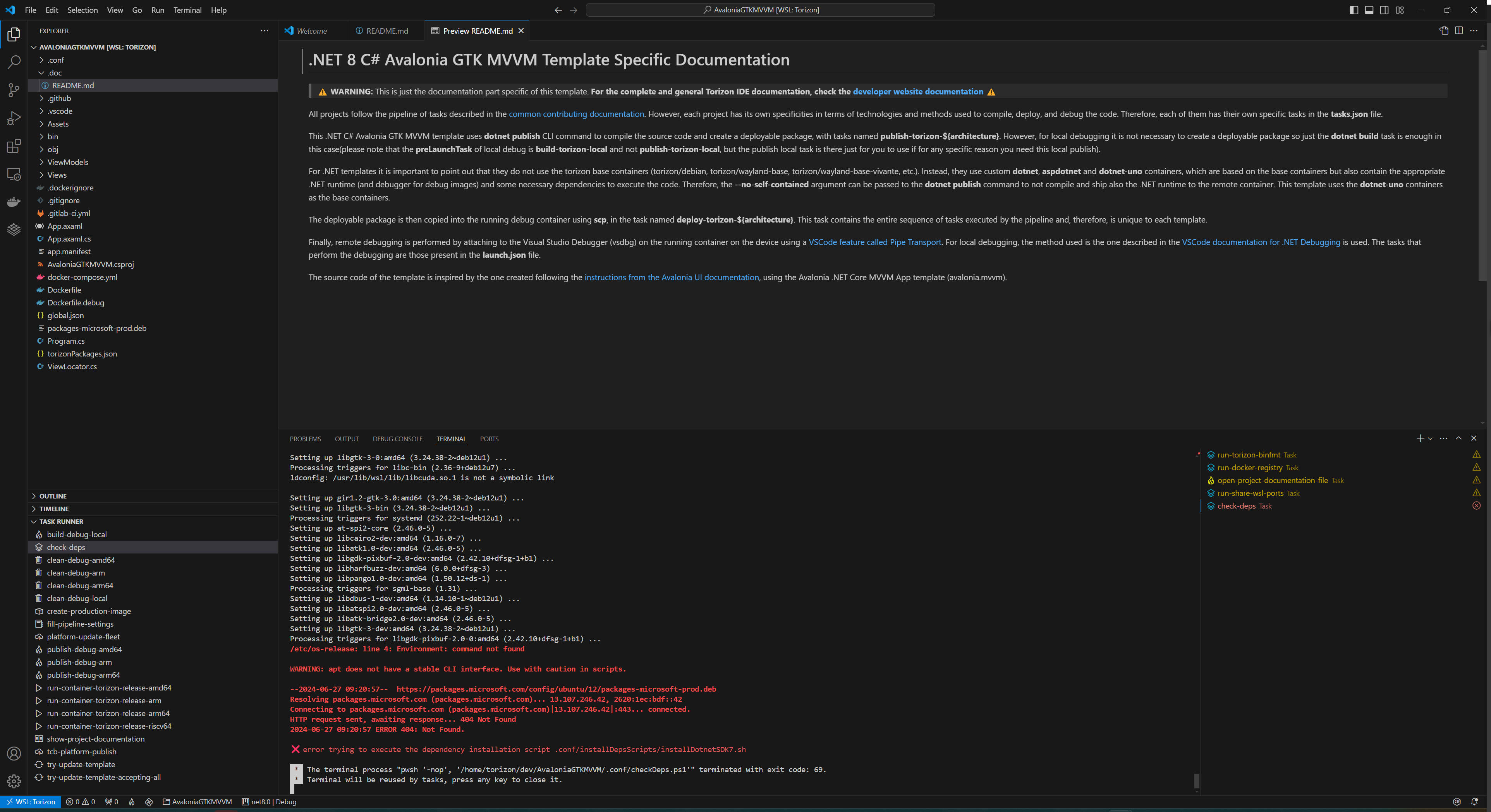

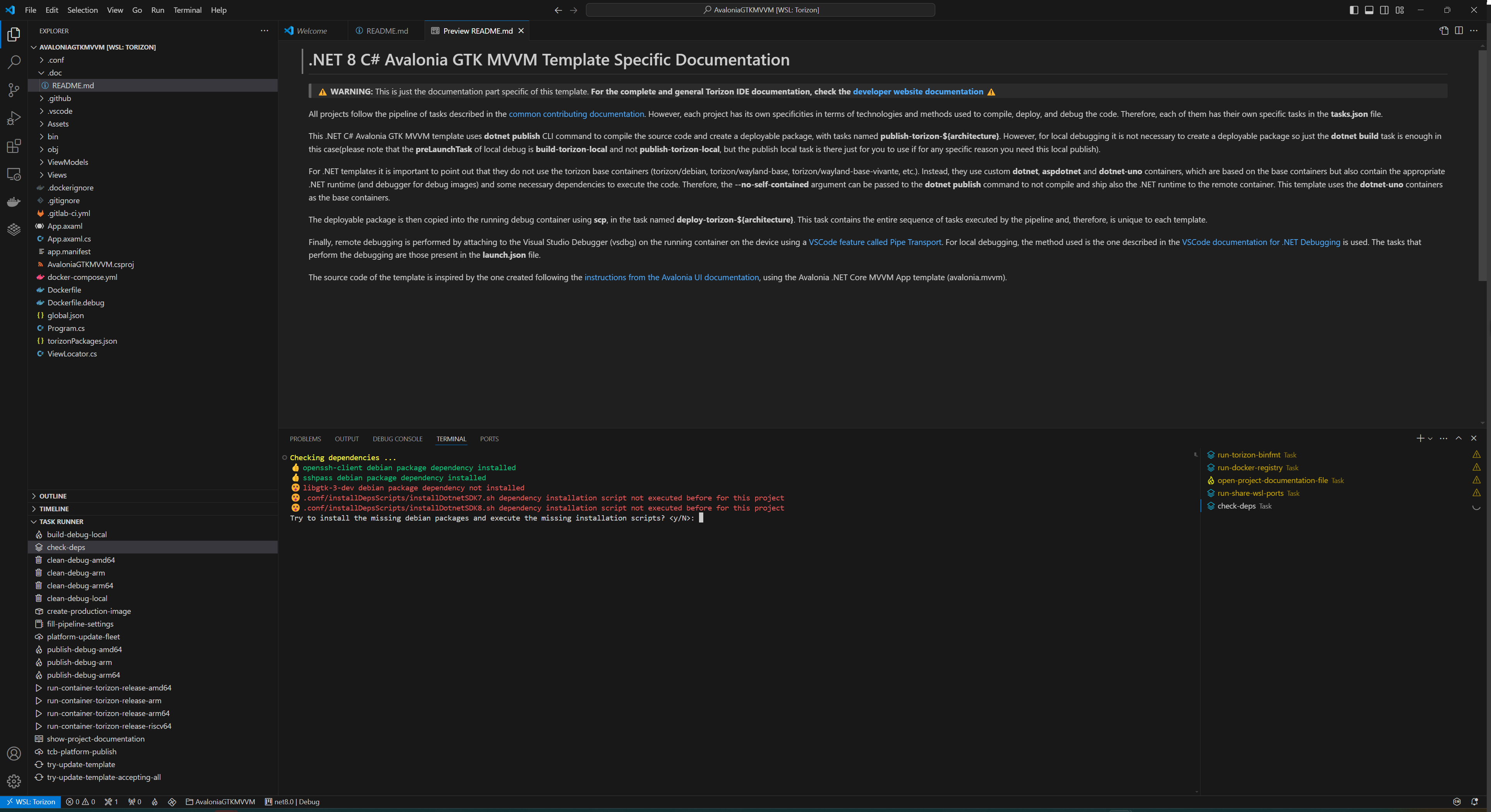

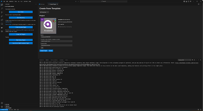

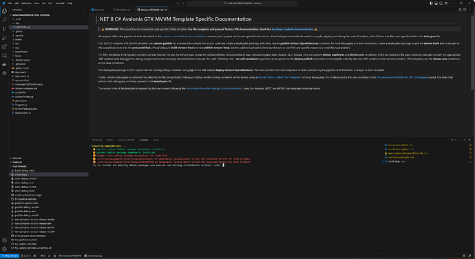

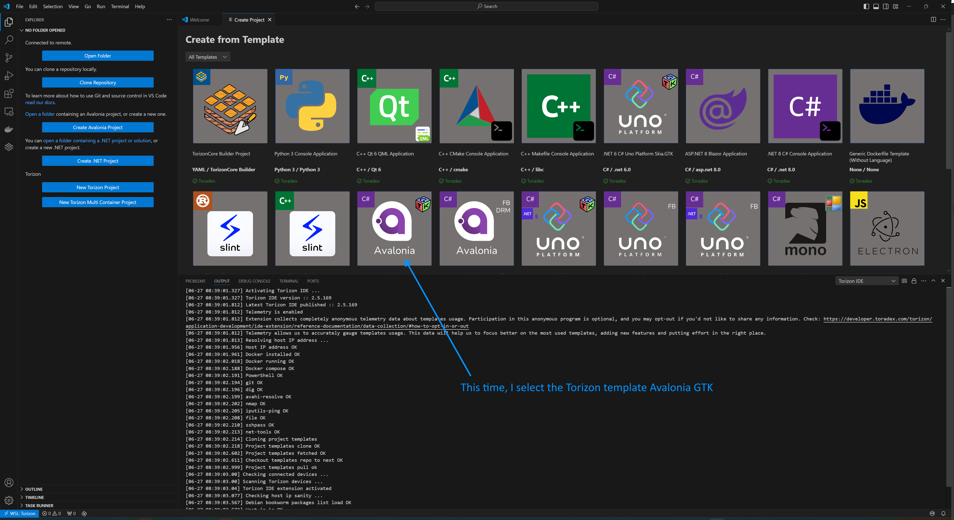

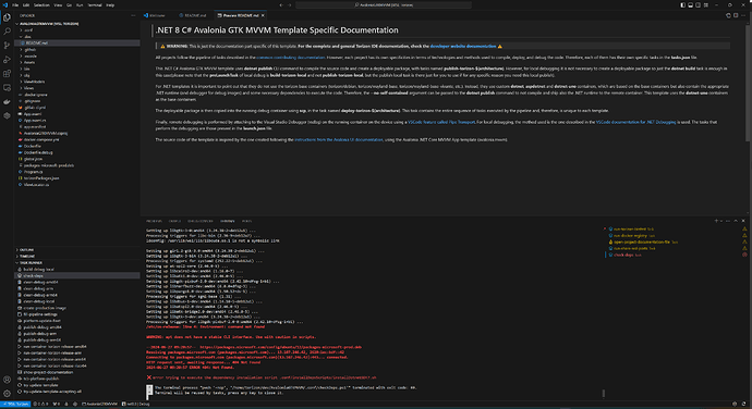

I have tried today to make another try using another Torizon template project : Avalonia GTK MVVM C#/.NET 8.0 (See on following screenshots), how I proceed.
Checking dependencies ...
👍 openssh-client debian package dependency installed
👍 sshpass debian package dependency installed
😵 libgtk-3-dev debian package dependency not installed
😵 .conf/installDepsScripts/installDotnetSDK7.sh dependency installation script not executed before for this project
😵 .conf/installDepsScripts/installDotnetSDK8.sh dependency installation script not executed before for this project
Try to install the missing debian packages and execute the missing installation scripts? <y/N>: y
[sudo] password for torizon:
Hit:1 http://deb.debian.org/debian bookworm InRelease
Get:2 http://deb.debian.org/debian bookworm-updates InRelease [55.4 kB]
Get:3 https://download.docker.com/linux/debian bookworm InRelease [43.3 kB]
Get:4 http://deb.debian.org/debian-security bookworm-security InRelease [48.0 kB]
Hit:5 https://packages.microsoft.com/debian/12/prod bookworm InRelease
Get:6 https://download.docker.com/linux/debian bookworm/stable amd64 Packages [25.7 kB]
Get:7 http://deb.debian.org/debian-security bookworm-security/main amd64 Packages [161 kB]
Fetched 333 kB in 0s (1497 kB/s)
Reading package lists... Done
Building dependency tree... Done
Reading state information... Done
The following additional packages will be installed:
  adwaita-icon-theme at-spi2-common at-spi2-core dconf-gsettings-backend dconf-service fontconfig gir1.2-atk-1.0 gir1.2-atspi-2.0 gir1.2-freedesktop gir1.2-gdkpixbuf-2.0 gir1.2-glib-2.0 gir1.2-gtk-3.0
  gir1.2-harfbuzz-0.0 gir1.2-pango-1.0 gsettings-desktop-schemas gtk-update-icon-cache hicolor-icon-theme icu-devtools libatk-bridge2.0-0 libatk-bridge2.0-dev libatk1.0-0 libatk1.0-dev libatspi2.0-0
  libatspi2.0-dev libblkid-dev libbrotli-dev libcairo-gobject2 libcairo-script-interpreter2 libcairo2 libcairo2-dev libcolord2 libcups2 libdatrie-dev libdatrie1 libdbus-1-dev libdconf1 libdeflate-dev
  libepoxy-dev libepoxy0 libexpat1-dev libfontconfig-dev libfreetype-dev libfribidi-dev libfribidi0 libgdk-pixbuf-2.0-0 libgdk-pixbuf-2.0-dev libgdk-pixbuf2.0-bin libgdk-pixbuf2.0-common libgirepository-1.0-1

/etc/os-release: line 4: Environment: command not found
WARNING: apt does not have a stable CLI interface. Use with caution in scripts.
--2024-06-27 09:20:57--  https://packages.microsoft.com/config/ubuntu/12/packages-microsoft-prod.deb
Resolving packages.microsoft.com (packages.microsoft.com)... 13.107.246.42, 2620:1ec:bdf::42
Connecting to packages.microsoft.com (packages.microsoft.com)|13.107.246.42|:443... connected.
HTTP request sent, awaiting response... 404 Not Found
2024-06-27 09:20:57 ERROR 404: Not Found.
❌ error trying to execute the dependency installation script .conf/installDepsScripts/installDotnetSDK7.sh
 *  The terminal process "pwsh '-nop', '/home/torizon/dev/AvaloniaGTKMVVM/.conf/checkDeps.ps1'" terminated with exit code: 69.
