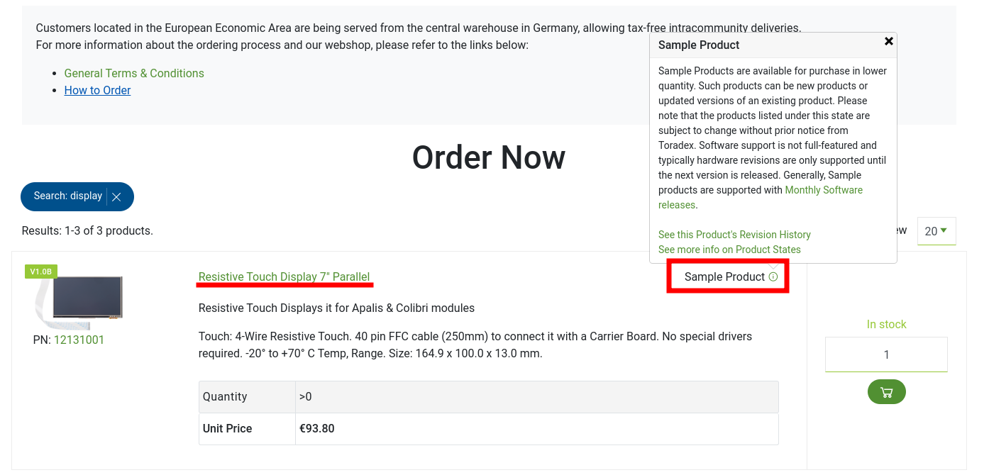

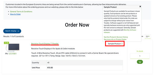

Seems like you are using this display right: Resistive Touch Display 7" Parallel | Toradex Developer Center?
Please be aware that this product is currently in the sample stage and is not recommended to be used in the end product:
