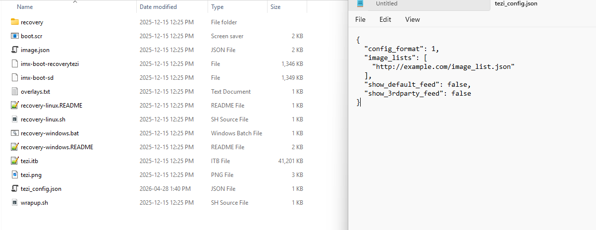

We are looking for something like shown in the attached picture. So when we load TEZI via UUU, it should pick up by default.

The URL hardcoded is tough to manage. Can we make it flexible so that it reads a JSON file in TEZI and uses it as a feed?
Another option would be to rebuild the TEZI with our URL, which is time-consuming.
Yes, you can use image_list.json to specify the IP address of your HTTP server and load images from it. However, this image_list.json file must be included in the TEZI image itself (typically under /etc) that you are booting from USB.
To achieve this, you would need to either rebuild TEZI from scratch or modify the existing tezi.itb to include the updated image_list.json.
