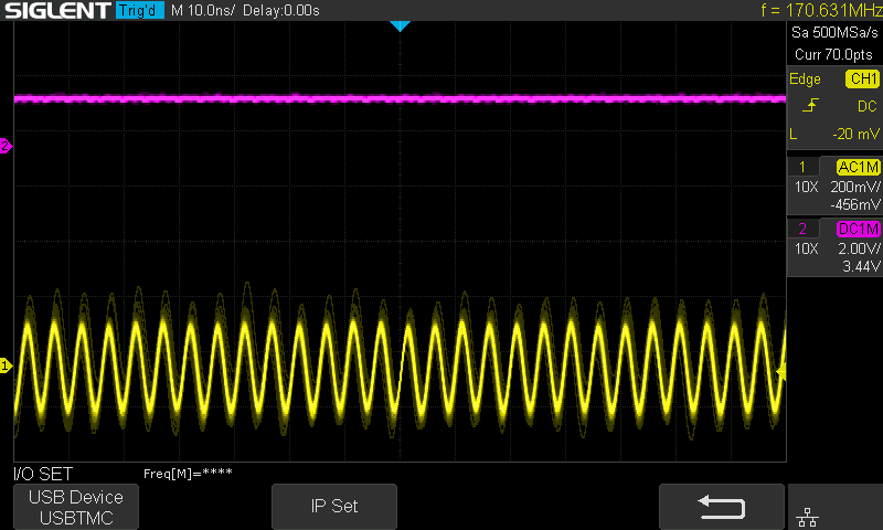

We were able to test a nightly build on two separate setups. The fix is present on our latest BSP7 nightly. Download Links | Toradex Developer Center
The build we used was Verdin-iMX8MP_Reference-Multimedia-Image-Tezi_7.3.0-devel-20250714+build.388.
The data we got was the following:
root@verdin-imx8mp-XXXXXXXX:~# cat /etc/issue
TDX Wayland with XWayland 7.3.0-devel-20250714+build.388 (scarthgap) \n \l
Verdin-iMX8MP_Reference-Minimal-Image
root@verdin-imx8mp-XXXXXXXX:~# uname -a
Linux verdin-imx8mp-XXXXXXXX 6.6.94-7.3.0-devel #1 SMP PREEMPT Mon Jul 14 12:47:24 UTC 2025 aarch64 GNU/Linux
Channel 1 is the HDMI clock, channel 2 is the HPD line. Both seem to be working now as expected.
The BSP team resolved the issue again on kernel 6.6. The fix is available on nightly builds starting from TDX Wayland with XWayland 7.3.0-devel-20250714+build.388.
The current fix is closer to what is implemented on the upstream kernel.
