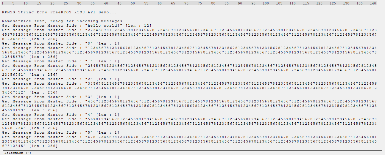

Here is the result of the test with the TTY approach:
If I send a random array of digits from Linux side (length > 1500 bytes)
Out of the box I get in the M4 ‘PRINTF’s’
At some point the data stream is chopped up.

Nice. ‘Swiss2’ confirms my experience exactly.
There I read again that the buffer sizes are compiled fix into the kernel.
It’s a shame because the RPMSG interface works very well. But only up to 256 bytes / transfer.
I would have to reassemble the split stream.
But that’s not a nice solution.
