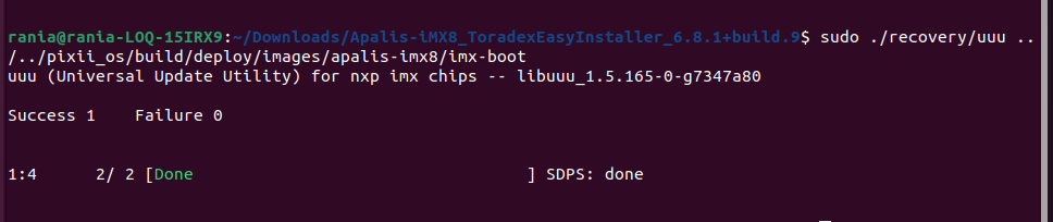

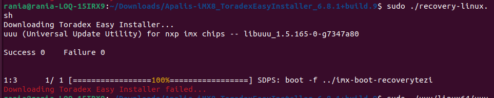

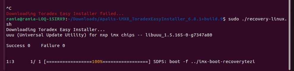

Thank you for the suggestion. Unfortunately, I cannot interrupt the U-Boot countdown because the serial console is completely blank upon powering on the board.
The eMMC boot partitions were accidentally erased earlier. The board currently falls back directly to Serial Downloader (USB Recovery) Mode.
I have tried pushing Toradex Easy Installer (both 6.8.1 and 5.7.6) via uuu to recover it. In both cases, uuu reaches 100% on the SDPS: boot -f stage, but the board instantly halts in RAM and the serial console remains completely dead.
Interestingly, if I push my custom Yocto imx-boot via uuu, I get SDPS: done (meaning it executes), but since it is a production bootloader, it still leaves the console blank as it fails to find the eMMC.

The SDP handoff is the actual blocker. Your custom imx-boot reaches SDPS: done, so ROM/SECO accepted it. The reference Tezi install stalls at step 1 of 3 and never re-enumerates. That difference points to an SRK mismatch on the reference image, not confirmed yet.
Can you send uuu -v from both attempts, and if you still have the CST/SRK files used for the custom build, try signing a Tezi SPL/U-Boot with them and pushing it through the installer script.
If that clears step 1, the module just needs a signed image, a normal install will rewrite boot0 and boot1 on its own.

Thank you for the detailed analysis. I appreciate the help, but I can confidently say that I have never run the fuse prog command or blown any fuses on this board. The module should still be in the factory “Open” state.
Despite this, the board is now completely unresponsive to USB recovery. I am using a native Linux host with no USB hubs. Even when performing a strict cold-boot hardware sequence (disconnecting all power, shorting JP4, applying power, and releasing JP4), the board fails to enumerate on the USB bus. lsusb shows nothing, and running sudo ./recovery/uuu -v with my custom bootloader (or the TEZI bootloader) just hangs endlessly here:
Plaintext
