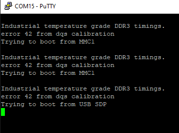

This morning, I booted the device and got this serial output
The board doesn’t even reach U-Boot.
I tried to follow this solution: Stuck in Commercial temperature grade DDR3 timings. Trying to boot from MMC1 - Technical Support - Toradex Community

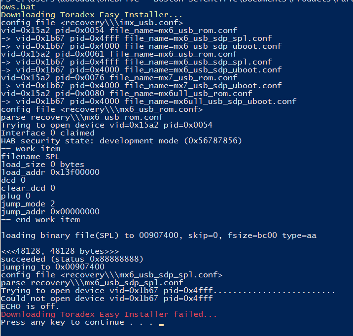

But it did not work. I launch the board in recovery via hardware mechanism (short the JP4 recovery pins for more than 6 seconds) and am connected to my PC with the Debug cable and JP2 jumper removed.
Launching the recovery gives me the following output:
And I am kind of stuck there with this board. I have spare iMX6’s but this one seems unusable for now. Not sure how it happened overnight or what to do to fix it from here.
