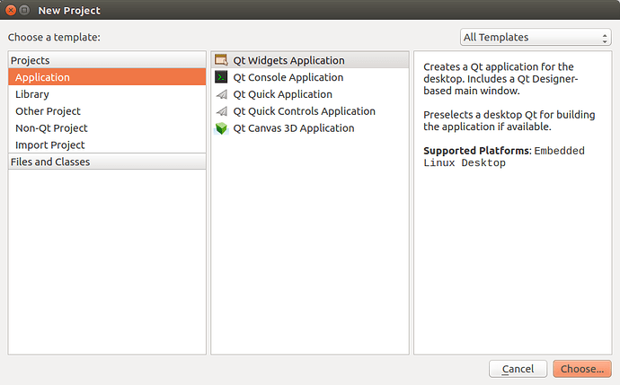

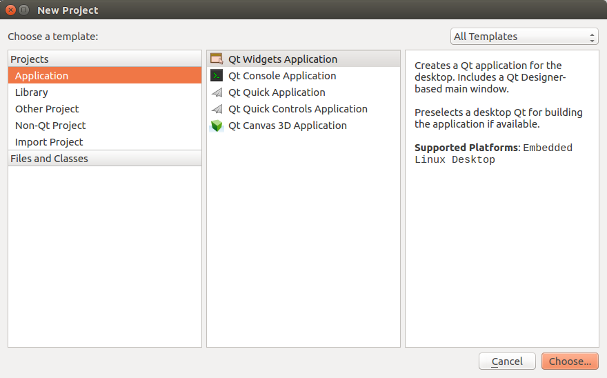

I am trying to make a simple form in Qt creator and deploy in Target. But I was not able to find a article in Toradex for this like a "Hello world QT project:
When I start a Project QT shows different type of projects and I tried one by one, but my build process is not getting through. Something totally messed up . around 200 error messages.

I am attaching my screen shots here

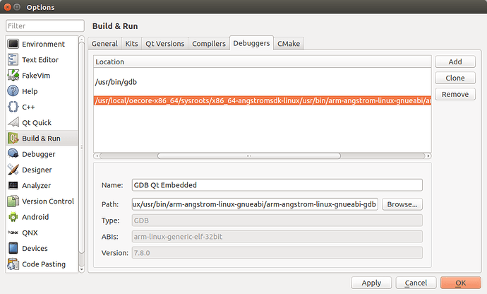

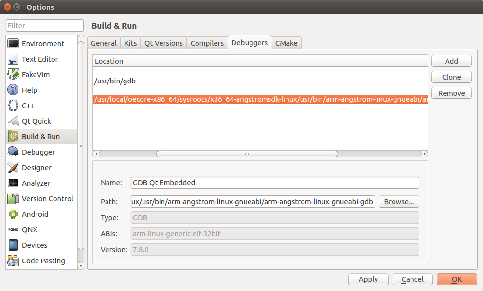

3) In your target(Board Toradex) GDB is installed? However, the image must have support for GDB to work with the librarys, for example to buildsystem with Yocto enable dbg-pkgs and tools-debug.
