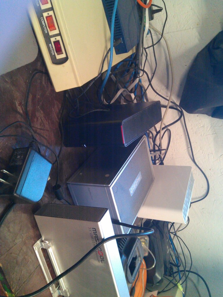

Gospel truth, I used to have a lot of consumer grade NAS scattered around my office.

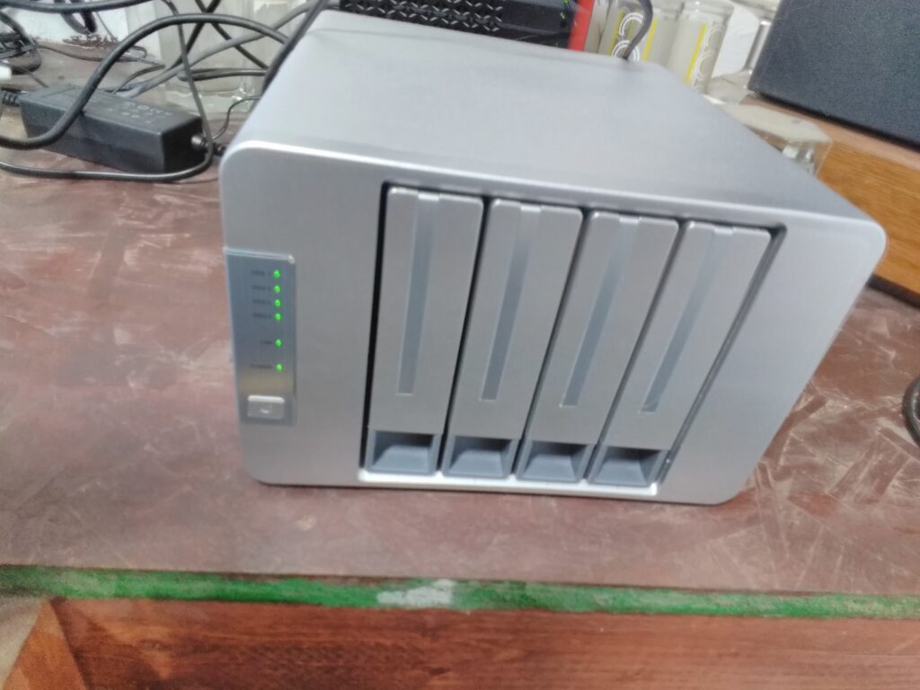

I only archived stuff to them because they were just slow. Thankfully they all hit end of life as far as manufacturer support was concerned. I junked them all and installed a TerraMaster NAS.
I stuck four 4TB WD RED in it. Waited a day and a half for it to get done prepping the drives, and now it is blindingly fast. I can copy an entire ISO to/from it limited only by the Gigabit speed of my network. Writing to it across the network is faster than writing to a consumer grade disk in the computer I’m using. Can be a tiny bit slower to get the write started if the thing is idled down, but amazingly fast after that.
