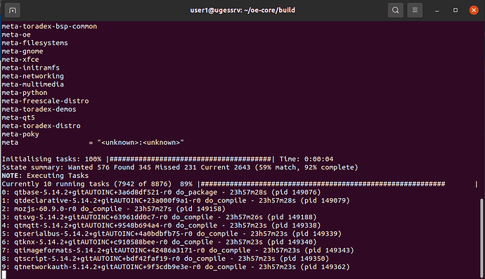

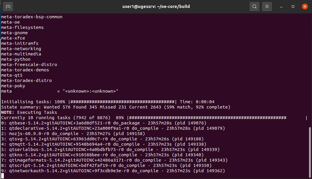

Hi there,
I want to build tdx-reference-multimedia-image for Colibri iMX7 Dual 1GB. I have followed this link. After running bitbake tdx-reference-multimedia-image progress was stuck.
I attached 2 picture of the progress.
By the way, I have built tdx-reference-minimal-image. There was no problem. I deployed image. Attached images are below.

Just a general rule, you need to have 8GB of RAM for each CPU core one allows the build process to use. Your screen shots are a bit tiny to read on this laptop, but 16 concurrent tasks would need 128GB of RAM to be safe.
I don’t remember the switch off the top of my head and I’m not at my office, just surfing through email with breakfast. I just know there is one. Use it to reduce the number of concurrent tasks to RAM / 8GB.
People get lulled into thinking their system can yocto with the best of them building the less resource intensive images, then they go for gusto and things like this happen. You have a deadly embrace going on where each process is waiting for one of the others to complete and free up its RAM for them to use. This routinely happens with some of the build processes but is a show stopper when it is all of them.
That would be the first thing to look at. Yes, your build will take longer.

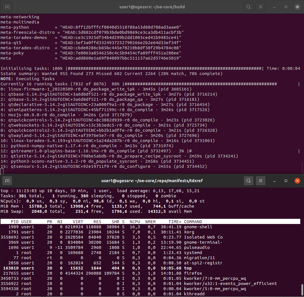

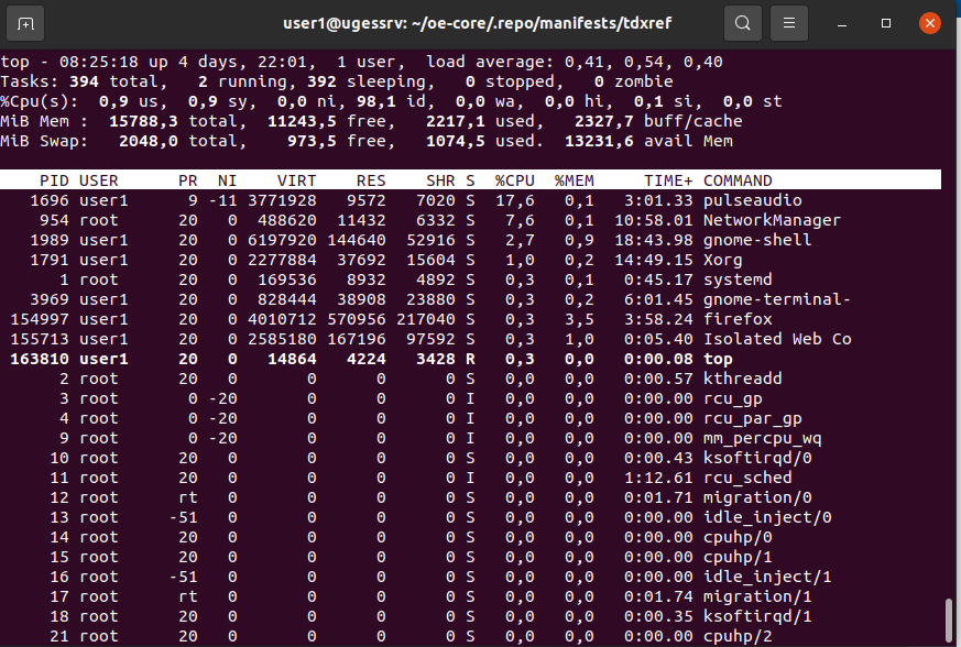

My CPU usage is very low. I don’t understand exactly. The top command output from the computer is mentioned below.
Have you any suggestion for me? I am waiting the end of the process. Thank you,

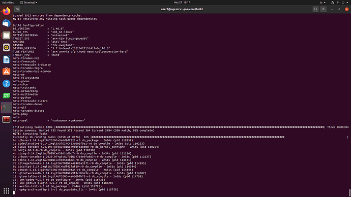

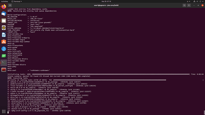

Hi Hiago,
İ have started build process from scratch in this morning. The screenshot of the process is attached. Could you check the process?
Thank you,
Osman
Hi @bossman48,
It seems like it’s correct. I can see it running without errors, but I don’t know why your CPU usage is so low. Yocto is running 16 tasks at the same time, so it should be using more CPU.
It is stuck again? Were you able to complete your build?
Do you have a different computer that you could try this build?
Hiago.
Hi Hiago,
In my case, there is no error. I am confusing that i made something wrong. Therefore, i want to work on this link.
It is stuck. I can not complete the build. İ can try another computer later. ::frowning:
I cannot see any errors.
Thank you,
Osman
Hi @bossman48,
I made the exact same step that you did and I’ve never seen this kind of error before, that’s why I suspect there is something wrong with your system. If you could test it on a different computer, that would be good for us to investigate this problem.
While you can’t test on a different computer, do you want to try this inside a Docker container? We could try to isolate your system through a container.
I don’t know if you’re familiar with containers, but I could send you some instructions on how to do it.
Hiago.
