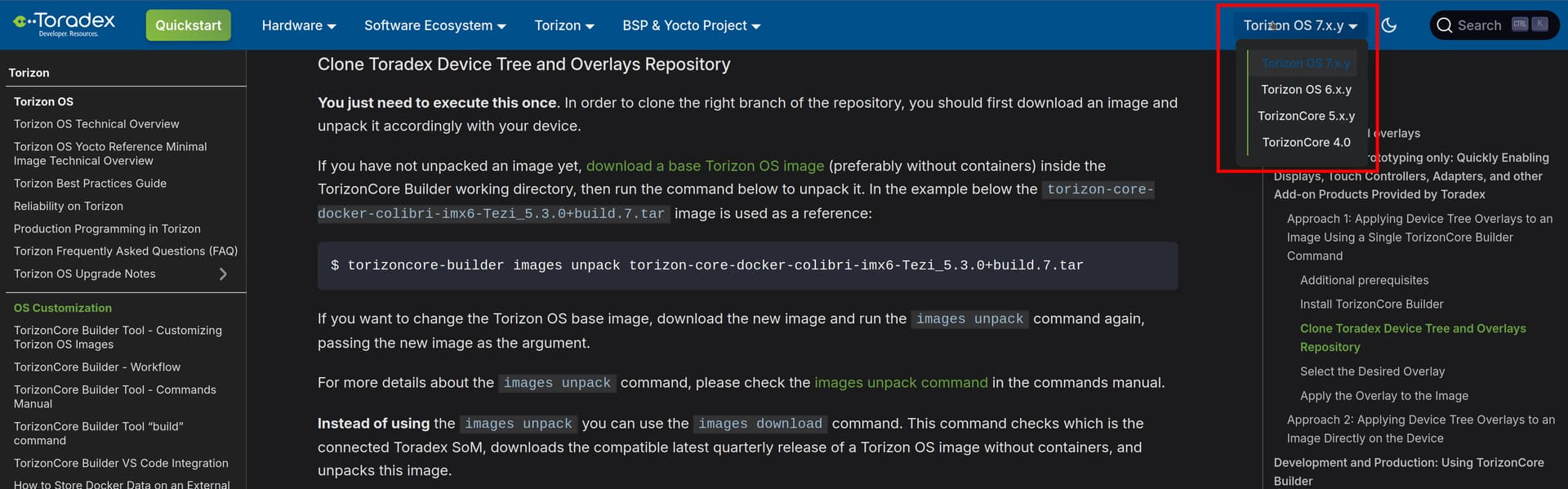

To view the documentation for an older version, you can hover over the drop-down menu on the top-right and select the version you are working with:
There you will find the correct instructions for Torizon OS 6, for example: Device Tree Overlays on Torizon | Toradex Developer Center
