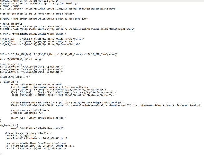

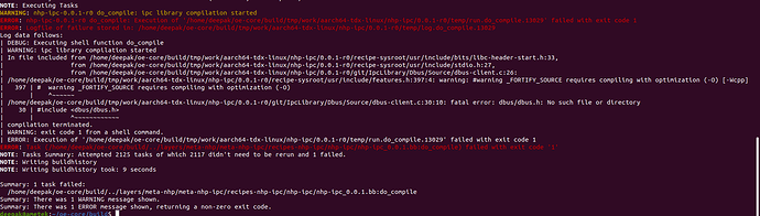

Thanks Ritesh,
It didn’t work after addition DEPENDS
DEPENDS = “dbus dbus-glib”
inherit pkgconfig
EXTRA_OEMAKE += “‘CFLAGS=${CFLAGS} -I${WORKDIR}’”
Please find complete recipe and error’s in the below screenshot
