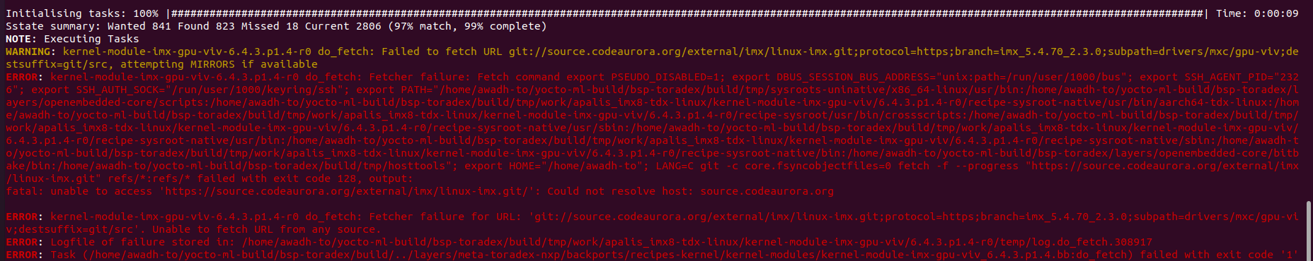

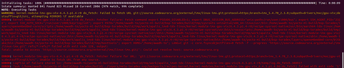

I’m getting the following error when building the reference minimal image (in both ver 5.7 and 5.4)-

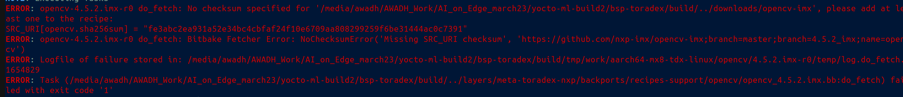

The codeaurora repo has shifted to github, but manually changing the links in the corresponding .bb file gives me a checksum issue -
I’ve added the line SRC_URI[opencv.sha256sum] = “fe3abc2ea931a52e34bc4cbfaf24f10e6709aa808299259f6be31444ac0c7391” to the .bb file.
