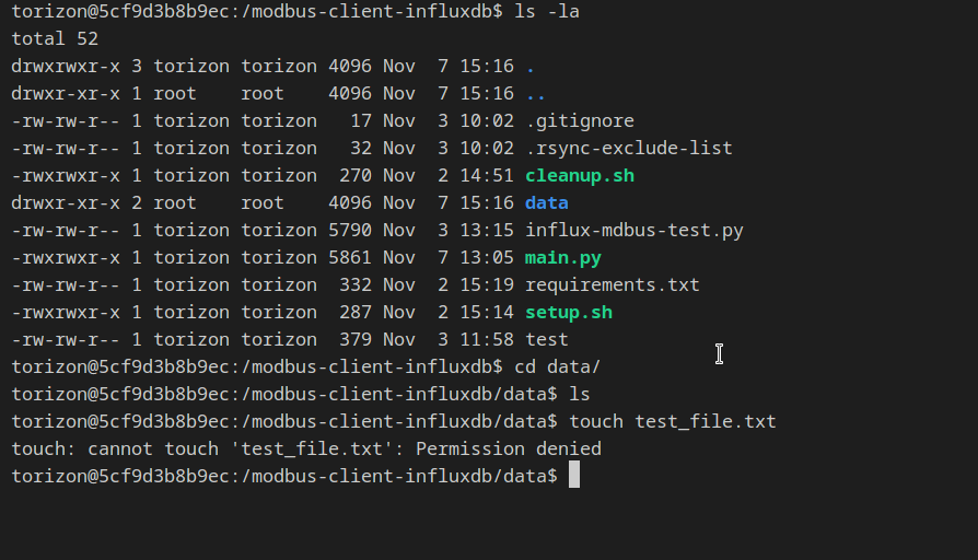

If you get into the desired folder, what is the output of ls -la?
What is the output of id from within the container?

I am inside the container and trying to create a file in data folder inside my app’s directory
I still get the same error.
it seems that the container doesnt have correct permissions for writing to the directory.
Is there a way to allow these permissions?
The output of id command is below
I am creating the data folder with python so it should have the same permissions as main.py it seems that somehow the created folder requires root privilages

Who is the owner and what are the permissions of the folder in your machine? (not in the container)
Josep
Hi, the owner should be torizon not root.

yes but any file/directory i create inside container using python gets created as root by default
I used a volume mount inside the app which I think already has a bind mount. so the app you create on the host pc already has a bind mount on your board. creating a named volume creates a directory on host with root permissions so my python app was not able to access it due to less permissions. removed the volume mount and it started working.
