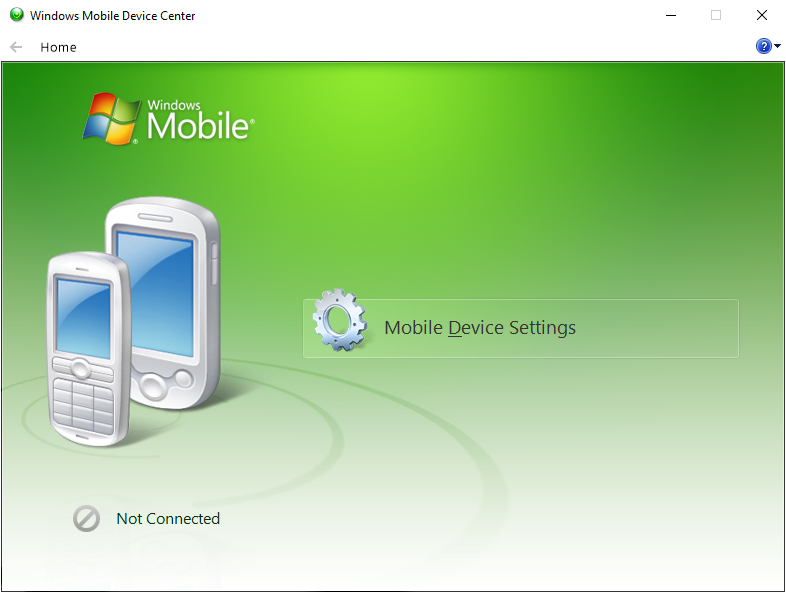

2- How exactly you are trying to connect it to Win 10? - What you are expecting and what is getting while trying to connect? -
We expect the Windows Mobile Device Center (WMDC) to establish a connection so we can use the remote software for example. We use the debug USB interface of the Colibri VF61.

Always we get not Connected message for WMDC.
Any suggestions !??
The problem is resolved.
In fact, it’s impossible to connect the WMDC to the device in the RDP session
